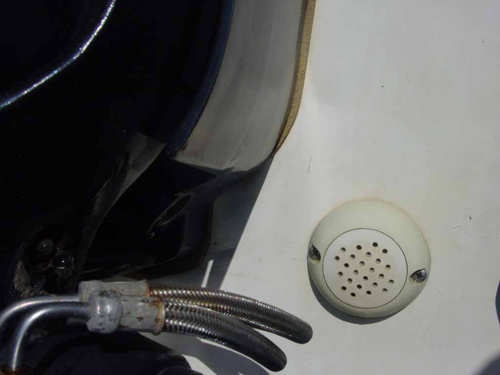

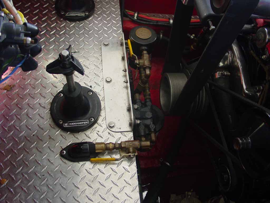

1) this is located on outer edge of drives, towards bottom. looks to be some sort of water pickup. but for ?
2) middle of transome between drives. i know the middle line is for speedo, but what are the two black things that hang below edge, & these 2 round white.
3) the lines are under port berth bench. my survey had pic of these that said "MSD system overboard seacock not locked in position to prevent overboad discharge on inland waterways". i assume this is from the head (not functioning). i since closed them, but could any damage have occured w/ them being left open?

Follow the strainer intake hoses back to the transom pickups. There should be a pair of ball valves back at the transom- these need to be shut off if you leave the boat docked unattended. They're also shut off when connecting a hose to that makeshift flush system- it lets the water feed the pump rather than spill out of the pickups.

Those white things are your Mercathode system. It's a positive-current anti-galvanic system (prevents corrosion when docked... in theory)

The black things are your sea water pickups. Pay attention to these- the one's like yours have a grate on the bottom to pre-strain sea water. They can plug with debris. Some people prefer to clean the strainer than doing their "Sea Hunt" imitation and going overboard to pull gook out of them. Remember, if you pop your strainer caps while floating, your boat will fill with water. That's what the ball valves are for.
