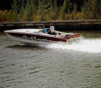

Here is a picture of a Bullet not doing it. Maybe it's the angle of the tips???

Here are some pictures of my ex Bullet running. You can see what I'm talking about. Maybe there is some kind of screen that would let air out but not let water in??? Sorry that I couldn't give you a straight answer, but I honestly don't know!

OldSchool - THAT IS EXACTLY MY PROBLEM!
I started to investigate when I noticed that I was collecting condensate (small drops of water) in the top half of the MPI intake plunums. Then I started to see some salt deposit on both #7 spark plugs, and I have had trouble with valves sticking.
Run with the hatch up just 1/4" and the transom is dry and so far the plugs look good.
Maybe the boats without the notch have this issue?
