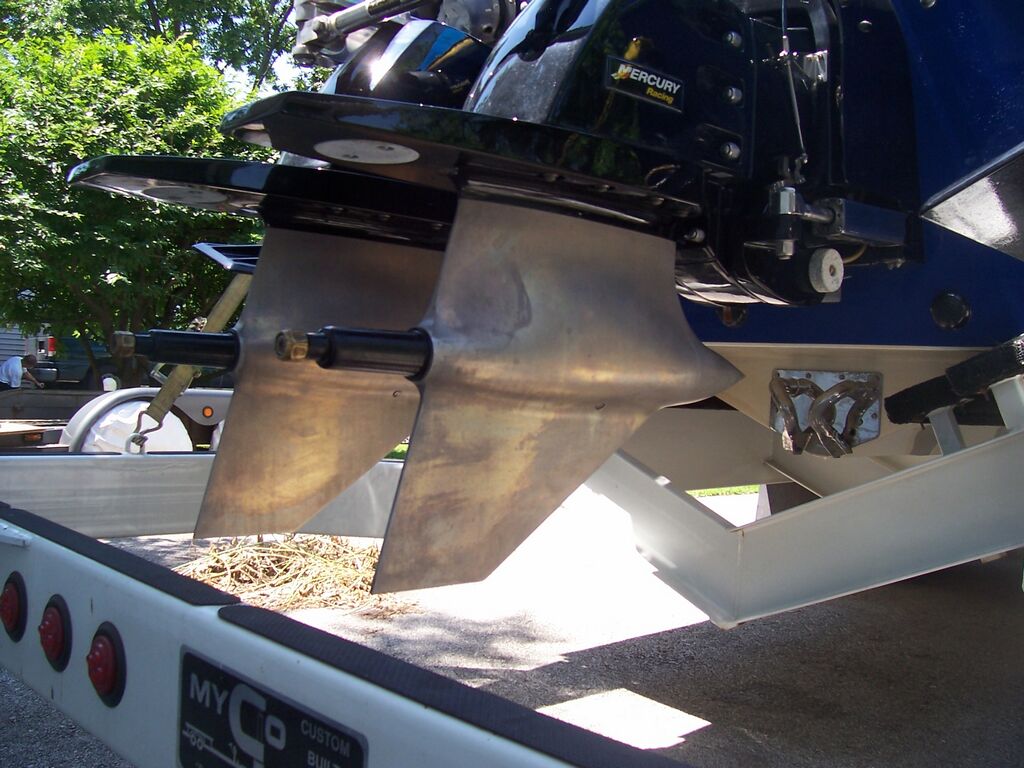

Is this in or out. Whatever it is it works great.

Are you going to stagger it or leave it side by side. the transom now is set up for 6's, if you run it the way it is set up now it will be pretty close. minus the weight of the V12's compared to V 8's. measure a number 6 then see where center is on the transom cutouts. it should get you very close.
As for turning in on staggers, it gives more speed and is only slightly less around the docks. Side by side motors and turning in again gives more speed, and on my 42 there was no difference in dock manners.
In theory if you keep it side by side and turn them in you should carry the bow a little more which will help you due to the loss in hp and the additional weight of the full cabin.

Basically all stagger step boats spin in. Good luck on the 46!

from the pic, yours are turning in. its the rotation of the prop as to whether it turns towards the center of the boat or the outside.
