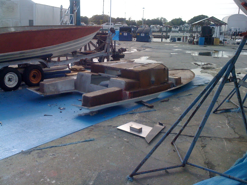

well tomarrow I start removing the plywood in the transom on the floor and some of the bad foam core spots in the seat.... seems as if the deck is hallow maybe rotted core... I'll have to drill a shallow hole to see to see if its rotted, if it is I have to cut it out also,,, I got the epoxy and core for the job when it was raining... so it will be fun tomarrow...

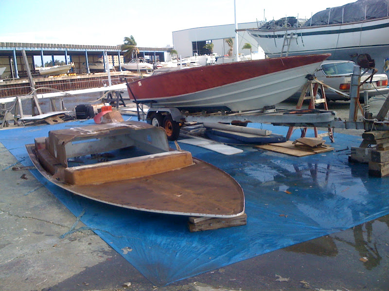

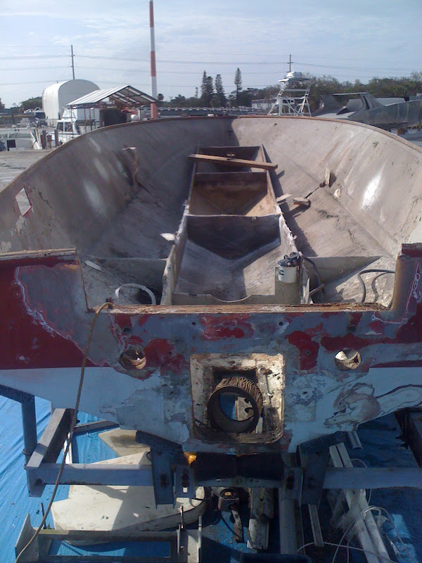

the first shot shows the floor being striped water thro out, then I sanded it to raw glass and photo 2 shows the wet kevlar and foam core and photo 3 in the core being covered... it will take about two days to fully cure in the 40/70 weather were having..
