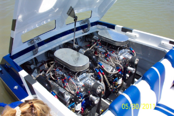

one more

Glad to see it at least got it in the water!! Cant wait to hear the results!

Kris, The boat looks great!!!!!! How did it run?

Ran good on Sunday. Still getting the motors dialed in. We added about 300 pounds of sand in the nose to get the balance better. When I went out Friday to test, waves were a good 2-4 and my nose kept getting sent sky ward. The nose weight made a huge difference.
Speed wise (I'm pretty happy so far) with sand in the front and 3/4 fuel. I rolled into the throttle one time and let off at 97 mph at 5500rpm. I think it will do a hundred. 4000rpm was 70-72 mph. 3200rpm was 55mph.

WOW.... Nice Results....A little prop work and I'm sure you'll be able to get the nose down some.

As part of re-doing the boat I removed the cabin. This winter we will be putting in a new cabin. I wanted to see how the boat ran with a light nose.
