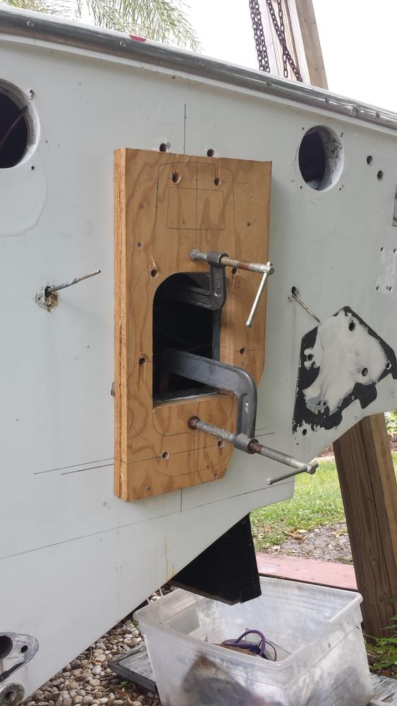

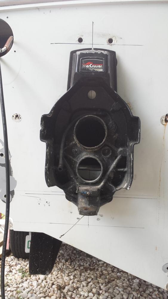

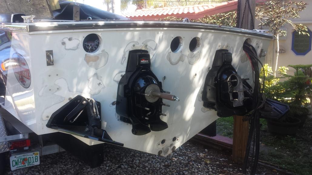

Will keep posting updates and photos, Tank, Rhythm.. I had nothing to work with JD knows that, so it took a bit of gathering. As the boat was configured for SSM drives, I had a chance at a pair of 26 spline #3's at a fair price. But the possibility of dealing with propellers and repairs made me think again. I already had a good complete set of TRS's from a Cafe that were complete right up to the flywheels. I want to mention that while I was measuring the X to convert the transom back to TRS, I realized that the cutouts for the SSM's had a hard sway to the starboard side. I might have not noticed this right away if I had gone ahead with those #3's I was looking at. I measured and measured again to be sure. I was able to see and measure the location of the original TRS drives that were on the boat. They were mounted on a 17.5 inch X. After reading much conversation on OSO I decided that since I had to modify the transom anyway that I would raise the X to 19.5 inches. We shall see how this works out. I had to make a TRS drill fixture which work out really well. I found a TRS alignment disk on ebay. The transom assemblies are on the boat now and I have an empty engine block mounted with the trans so I could install and align the engine mounting plates. I am using Gil manifolds and lower profile Gil full length dry risers. The engines of course will be 2 inches higher than original. Even with the lower profile Gil risers the risers will be above original engine hatch height. Wanted to get everything located before I repainted the transom. With some riser wedges I will be able the use the current exhaust cut outs again. Happy for little things. I have Mayfair external steering complete to the helm mins the TRS steering mount plates. Be looking and nothing usable yet. I do have one Latham TRS mount and one Mercury TRS external steering mount. In the end the mounts look rather simple after looking at dozens of photos. I will probably make the plates.

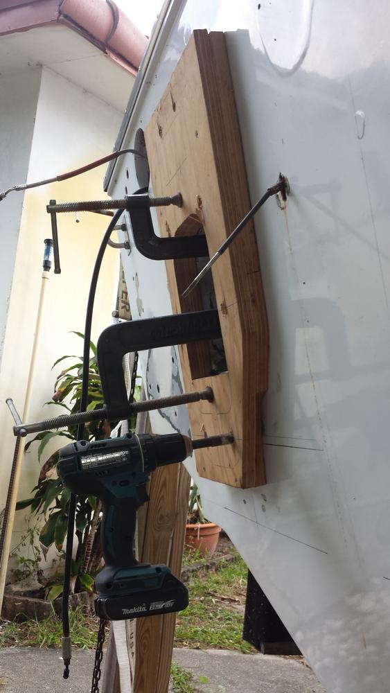

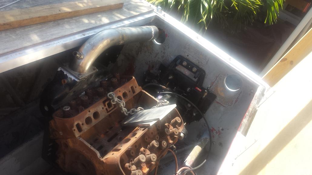

Ok here we go. When I purchased this boat I was so excited about the aspect of taking possession of it that I failed to notice that it was cut out for SSM's instead of TRS. Had I realized this I might have reconsidered. I was in the process of rasing the transom from 20 to 25 inches on my 1980 25 mako. I had removed the whole back of the boat. I never took on a project quite this large. Now I was faced with the Cigarette cut out for SSM's and I had TRS's. Wow. I have to say It took some imagination. I have crossed many hurtles right up to where I am now with the exhaust. Never Give Up! I have had a lot of support from some local boys around here that have a couple of warehouses full of Mercruiser parts. Many Thanks to Hank of Palm Beach Marine, and Bill who's shop is buried back in the warehouses close to Fort Lauderdale Airport. Here are some of the photos I have taken with my phone camera along the way. For now I am just fitting all the major components, then start the cleanup and paint. Engines are actually the easy part for me, but that is a ways off for now.

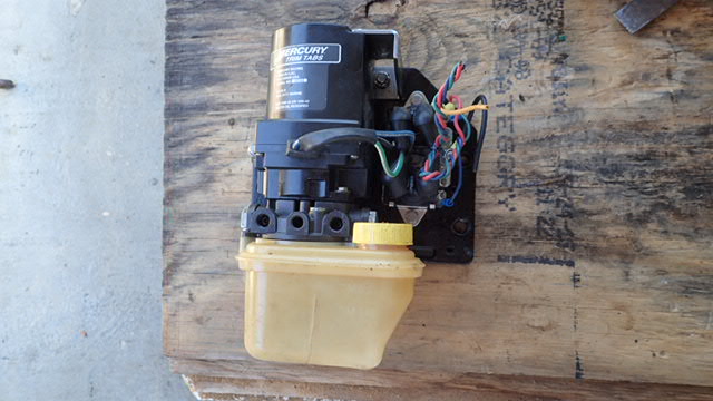

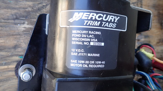

I am going to post a few photos of items that I have and am looking for one more of each. A Mercury Racing Trim Pump like the one in the photo (I have 3 already, need 1 more) and TRS external steering mounts. The Latham mount is #2150 and the Mercruiser mount is #85323

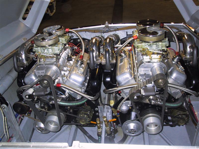

Also I attached a photo I found of what the engine compartment looked like in this boat at one time. The engine compartment opening was different at that time. [ATTACH=CONFIG]567790[/ATTACH][ATTACH=CONFIG]567791[/ATTACH][ATTACH=CONFIG]567792[/ATTACH][ATTACH=CONFIG]567793[/ATTACH][ATTACH=CONFIG]567794[/ATTACH][ATTACH=CONFIG]567795[/ATTACH]

I am returning the boat to TRS for now. I have some BAM redone C72's for the boat as well. I raised the X to 19.5 in. The engine sit quite high and the lower profile Gil dry risers I am using still come out of the engine compartment a few inches. If the hatches you are talking about are the same as the ones in the photo on this thread, they would be great to locate. I will in any event return a deserving Cigarette to live once again & and all help is much appreciated

Looks like previous owners photo of my Mistress. Would like to know how this boat ran with this configuration. Interesting power steering pump location. I am going to locate mine below the alternator. I have my drive to drive at 34 inches, this config is looks tighter then mine. I raised my drive height (crankshaft to bottom of boat) to19.5 inches from what originally looked like about 17.5 inches. I am using what i believe is a 3 inch rise Gil full length dry riser. In this photo the riser height is lower then mine and still are above the boat deck. I have no engine bay hatches as of yet. I have some glass experience, so looks like I will have to make. Nice photo!
