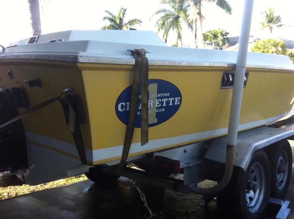

Here some more pictures. How hard is it to split the hull from the deck? I think I need to do a full restoration to this one.
once you gut it, there is lots of tabbing under the deck once you get the screws out. you can get most of it from crawling underneath, you cant sawzall it as the top deck actually has a lip that comes over the hull and is screwed.
I wouldn't remove the deck. The floor section above the gas tank was a real pain to remove. There are glass tabs that I had to cut out to replace the 40 gallon tank this past summer.
Would not do this if you dont have to !!
Good Luck with your project.

mine was split and totally redone bow to stern, i now have a 75 gallon tank that fits in the same spot as the other, just a little longer and a little deeper netted me 15 additional gallons.
