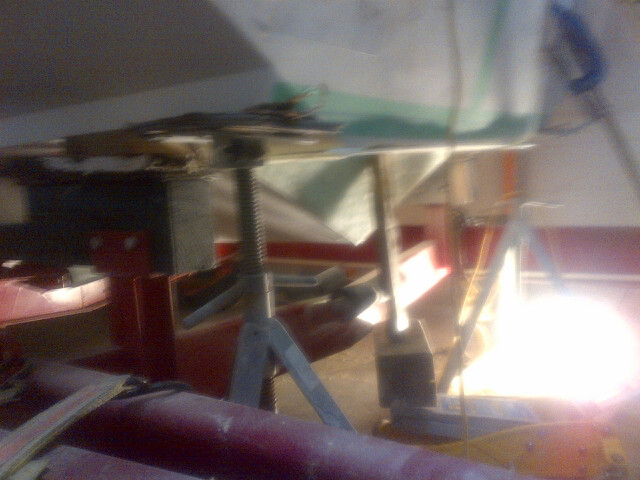

I was at the shop last night and started grinding and did a prelim fit of the notch panel. It will be a slow process of triming and fitting as I want the insert just right before I glass it in place . Automobli I have a reverse plug already made to set the ecterior material in place , as I will agree sanding and grinding upside is a pain .
Scippy I think I am as crazy as you because I like the smell too.
Ren3 , Toronto is a cool place , if you ever get back up here be sure to look me up.
If any one wants to fill in a notch I will make them a really good deal on the piece I cut .

Mild Thunder right on , the only difference for me is putting boxes on would cost a ton of dough and putting the notch is something I can do myself . ICDEDPPL the advantages are as I stated above the other advantage is helps reduce mid range proposing
RG.
