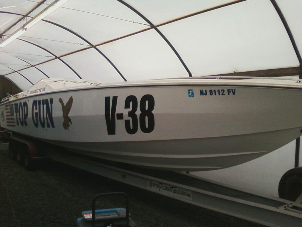

how much you want to spend on one ? i have a top gun that is carbon fiber its lighter an stronger then a all glass top gun it can take more power mine has 650hp motors with speed master #3 drives new cmi headers runs 82mph on trailer $65,000 takes it
