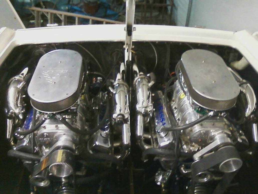

I have tall decks in my Flat deck and the drives are 36 inches on centre and I have a center hatch ram . I am running CMI tubular headers with about an inch of clearance either side , if that helps.
RG.
Rick G is offline
Old 04-26-2013 | 01:21 PM
Posts: 1,254
Likes: 44
From: Toronto Canada
Here are a few pictures if that helps.
RG.

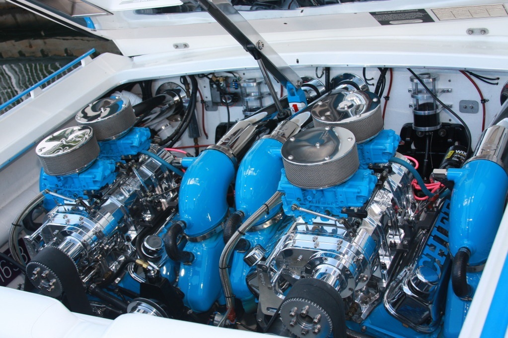

35 inch centers, clears easily.
