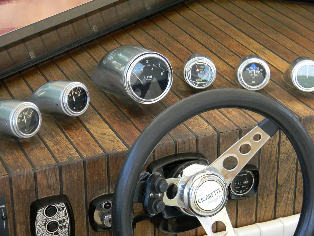

Maybe try salvaging the shrouds from your old gauges and use them with some of these, the mixture of the old school teak/shrouds with the newer style gauges would be pretty cool....

Or get a couple of these to put on top of the dash for the speedo/tach..
http://www.ebay.com/itm/370794032888...84.m1438.l2649
A setup similar to this was actually used by Cigarette as an option in that era..
Dave

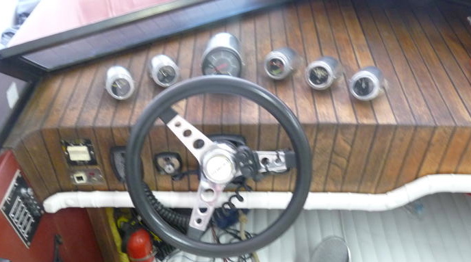

Yup. that's kinda like plan B. The Livorsi's, Gaffrig's and Autometer's all have too large of a rim to fit in the existing bezels. If I go with something like that I would pull the teak dash panel and re-fab with new cut-outs.
Here's how I accomplished it before (post #6). On the '79 I could not replace the teak. So I custom fabbed over-sized bezels to cover the larger holes.
http://www.offshoreonly.com/forums/c...ject-done.html
I could do that again, but with the current spacing almost all the bezels would have to be ground down on adjacent sides in order to fit.
