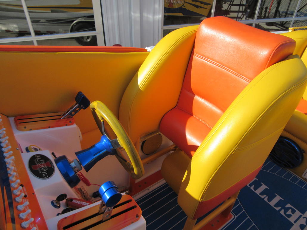

Just checked my photos and they are MM sticks
[ATTACH=CONFIG]554733[/ATTACH][ATTACH=CONFIG]554734[/ATTACH]

I had the same problem with my Marine Machine controls. The throttles were nice, but the shifters and finding neutral could be tricky. I have since switched to Latham. Much more precise when shifting between gears.
