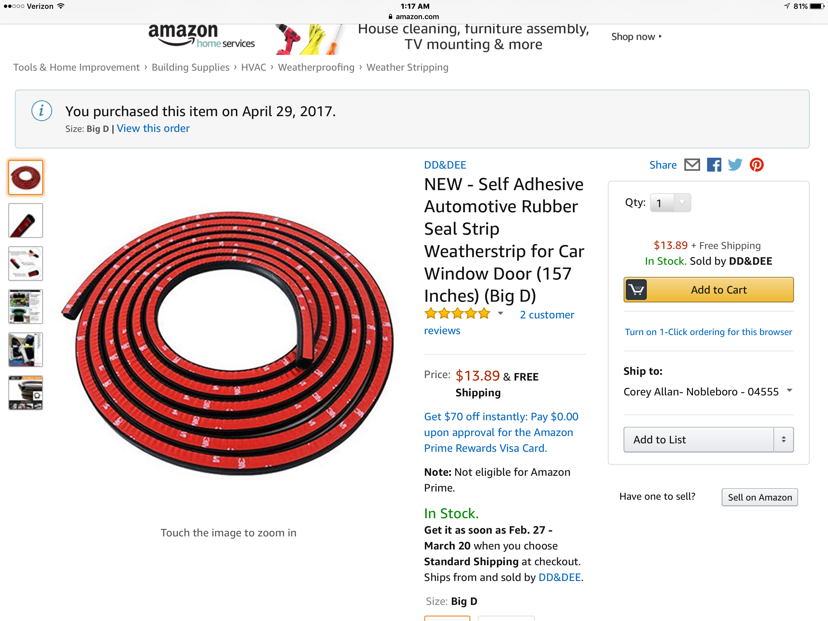

I'll add, if you do end up buying D Gasket, do not buy it from Lip Ship. Its cheap **** with very little adhesive holding ability.... I literally threw mine out and searched until I found this nice stuff w 3M adhesive. Just fyi...
