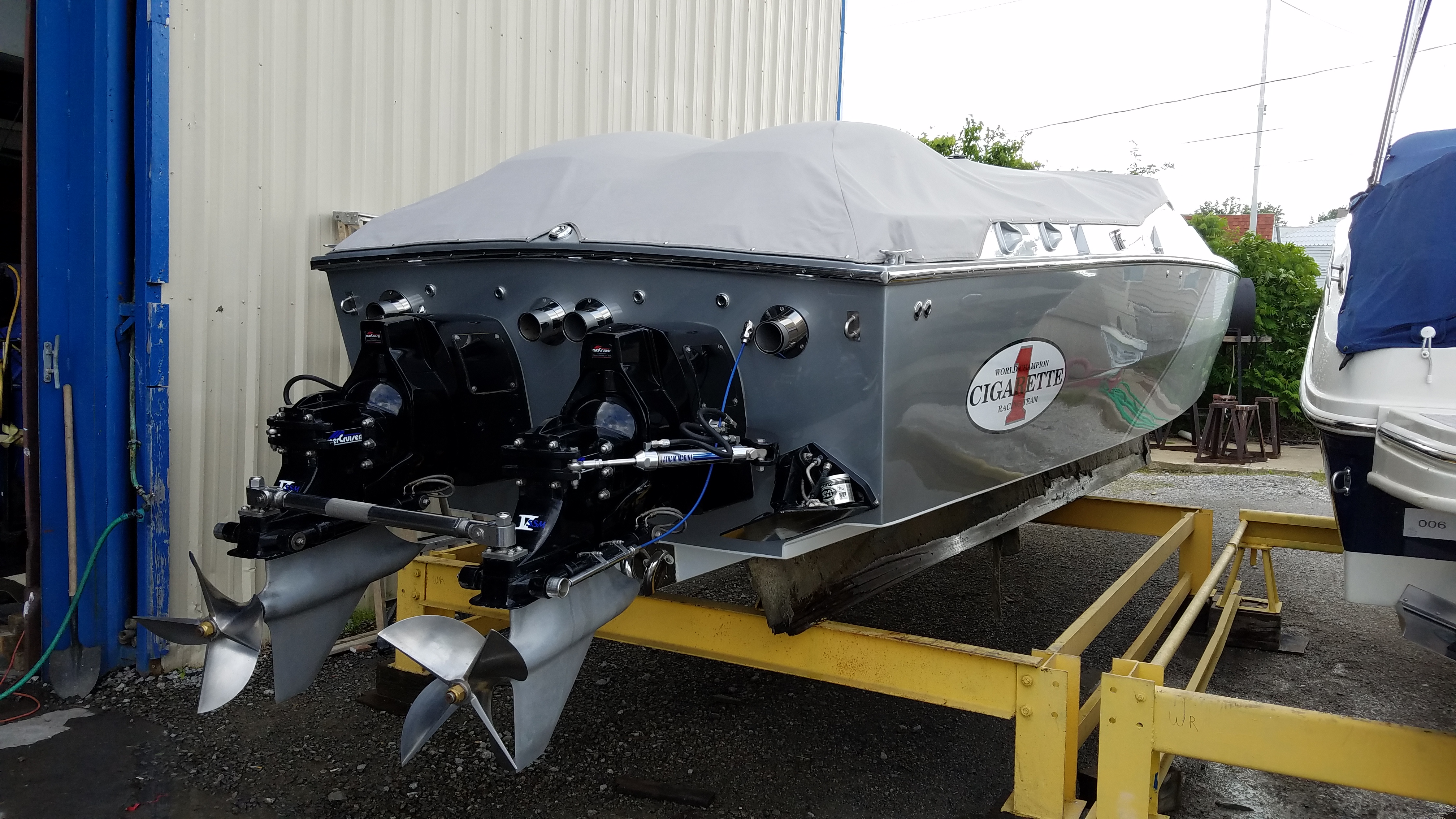

Anyone know what brand/part these are? Do they have internal mufflers? Looking for angle tips, no mufflers
mine are currently straight

Is that yours on the right? Interested to know more about that setup. Looks super clean! Looks like thru-transom tails but without the goofy gasket like I have.

Yes it is. They are solid tails that bolt to the exhaust manifolds and run right out the transom. The exhaust hole cut in the transom gets sandwiched first with stainless ring inside > transom > rubber gasket outside > stainless ring outside. Then you just push the tail pipe thru from the inside. Very simple, and clean.
Great to know! Mine is the same but there is a gap between the ring ID and Tail OD on the transom that shows the rubber. Yours looks much nicer with no gap. I need some new rings!

Here are ours...we opted for beauty rings on the inside too. Keeps it clean.
