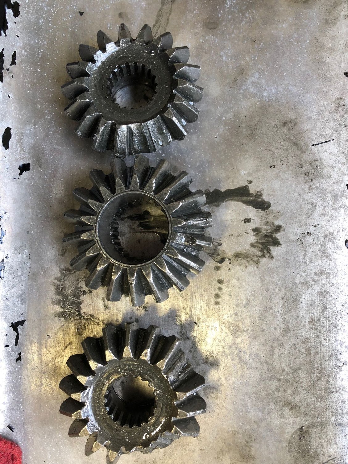

All the 3A are big shaft, trust me I never thought it would be a problem. Lasted about 50hrs behind 950hp, 17x30 3 blades @ 5" below the bottom. I run it hard, never really "airs out" its a Mistress LOL! I have Broken 1 upper SSM3 and 3 lower gearsets on SSM3 and now the lower gearset on my SSM3a. Always the RH drive, never have broken a LH anything!!!!!

From my understanding the SSM3's are closer to sizing to the TRS innards and the SSM4 is a shortened version of the SSM3, where the 3A is closer to internal sizing to the SSM6 and a SSM5 is a shortened version (lower) of the SSM3A. 3A's are well known for taking up to 1k HP.

Hence the reason I thought my problems were over LOL. If i could get the URL thing to work Id post a pic, lower gear set is destroyed! I "hear" of the ability to handle 1000hp, not the case for me. I can break a regular SSM3 in a weekend...
I have a line on a pair of 5s with a 3" spacer in them, I was just wondering if anyone has ever tried them on a boat like mine and if it would plane off or not, not really looking to go faster!

Originally Posted by EightSecv6
OUCH!
You sure it's not a balance issue or alignment issue. Breaking same drive over and over again? Kind'a weird.

yea im sure, nothing as far as alignment is gonna break the lower gearset on 4 different drives. I wouldnt expect a 3 to take the abuse but i DID expect the 3a to hold up. Rh lower drive, by design is the weaker of the 2
