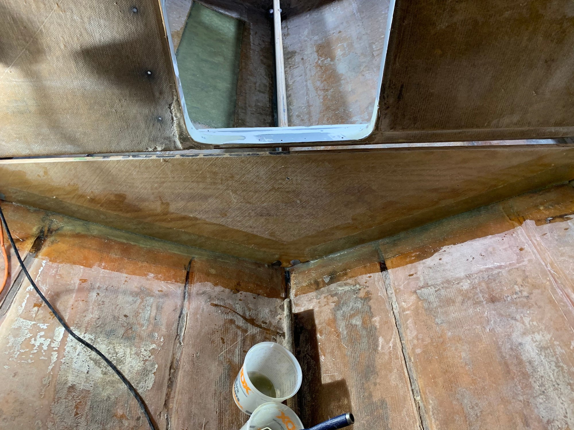

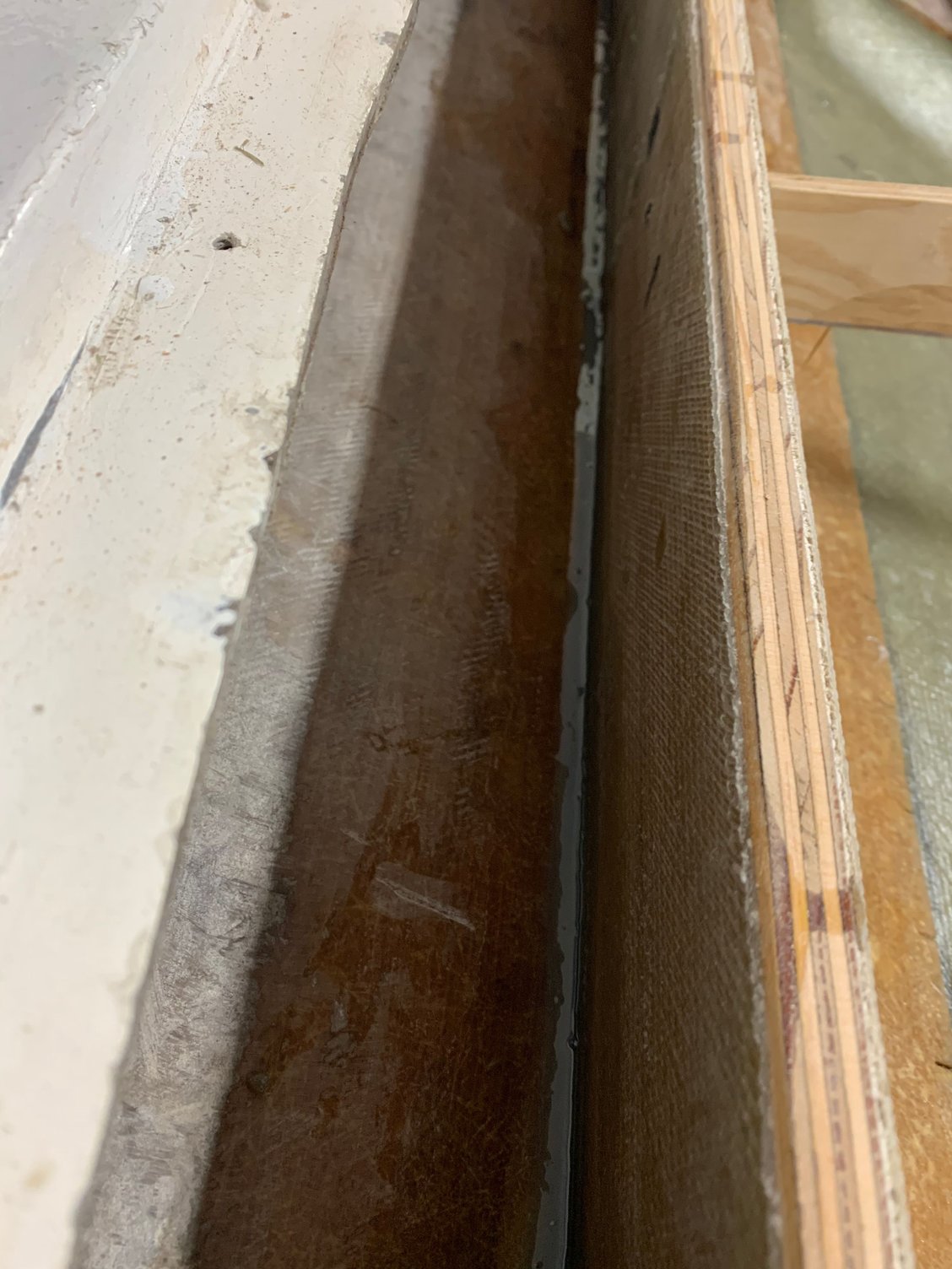

Center stringer bedded in
First cabin bulk head set
Outer fuel tank stringers tabbed in
Tabbed I’m lower side then mixed up thicken resin with fibers and let it settle in to fill any voids let that dry and on to tabbing other side and start wrapping with glass!!!
Got one layer of tabbing on inside
division1 is offline

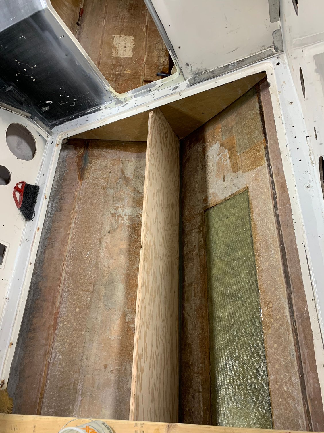

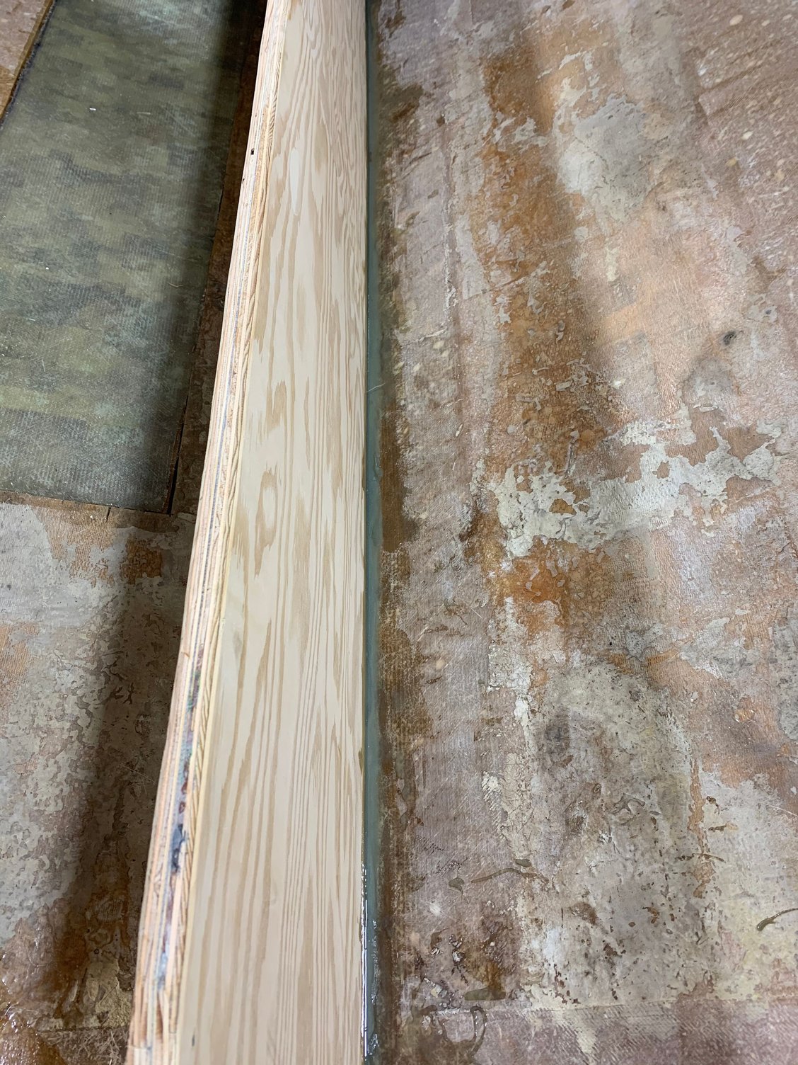

Old 10-01-2020 | 07:12 PM
  #525
Joined: Mar 2013
Posts: 1,003
Likes: 895
From: Cleveland ohio
While all that was drying with some help of a good friend got a string line set in the cabin and got a one cabin stringer made. We ran a string line level then measure every foot and transferred that to the board. The main stringers will be 2 layers on 1/2 ply laminated with 2 layers of 1708. I will then wrap them 3 times in the boat should make for about a 1 1/2 wide stringer. It was only a 3/4 ply stringer from factory that should help make it stronger !!

Old 10-01-2020 | 07:16 PM
  #526
Joined: Mar 2013
Posts: 1,003
Likes: 895
First cabin stringer made. 17 feel long !!!

Old 10-02-2020 | 07:14 AM
  #528
Joined: Mar 2013
Posts: 1,003
Likes: 895
Standard 8 feet sheets. The seams get staggered that’s why it gets laminated makes a strong stringer !!!
Old 10-02-2020 | 07:21 AM
  #529
Joined: Mar 2013
Posts: 1,003
Likes: 895
I build them on the ground and glass them together and then after they dry clean all the edges it is easier than trying to build it in the boat but man some 20 foot long sheets of ply would be really nice lol !!!!
