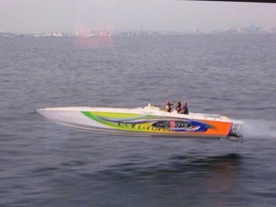

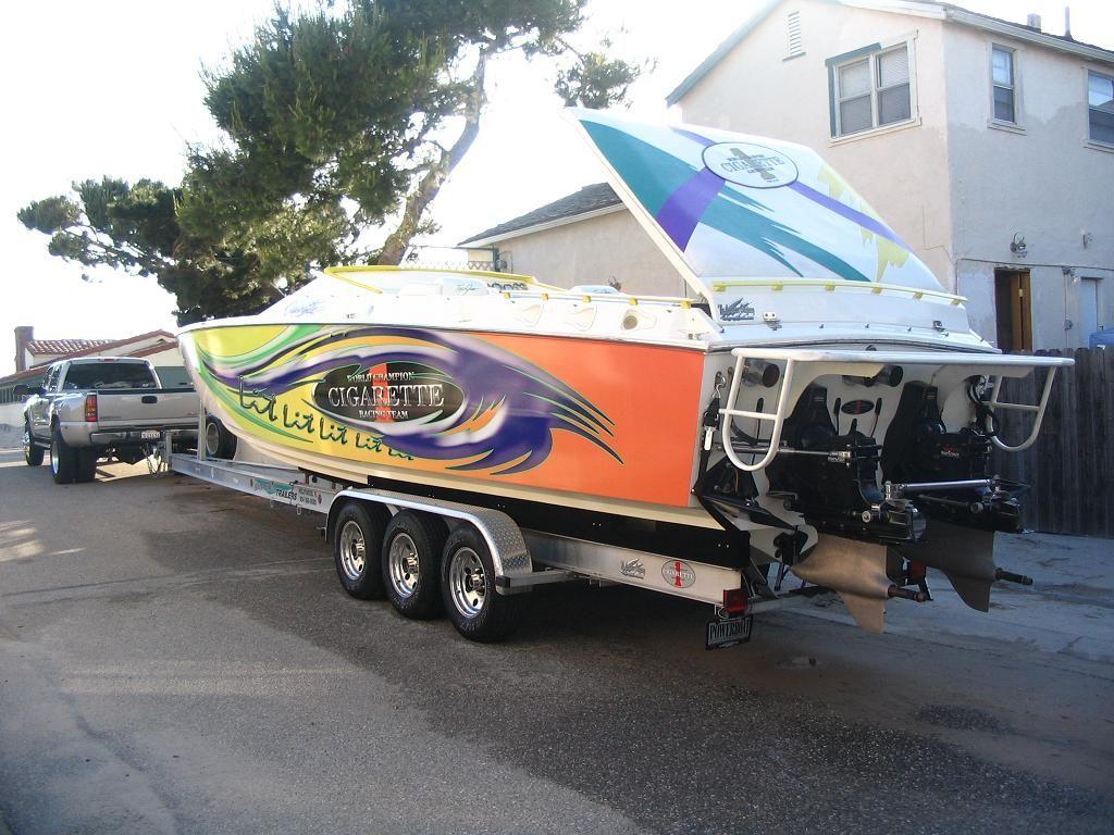

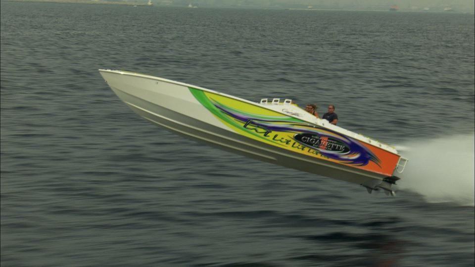

Agreed 100%. Our 3A shafts were pretty even with the hull. When running, I'd kick the drives out a bit and drop a little tab and you could feel the sweet spot the boat was happy to run in with minimum bow lift and unsticking the hull. I'd rather just mess with how you're running it (drive and tab setting) than go through the headache of running 5's. Just my .02
Here's an example of stills of us running in a video - photo of us pointing up was me running with the drives out a bit and no tabs down, trying to air it out for the helicopter. other shot is running in that sweet spot I was talking about. 3rd pic is where the drives were mounted for reference.

tyvm i see the answer is a lil bit more tab thks guy's
