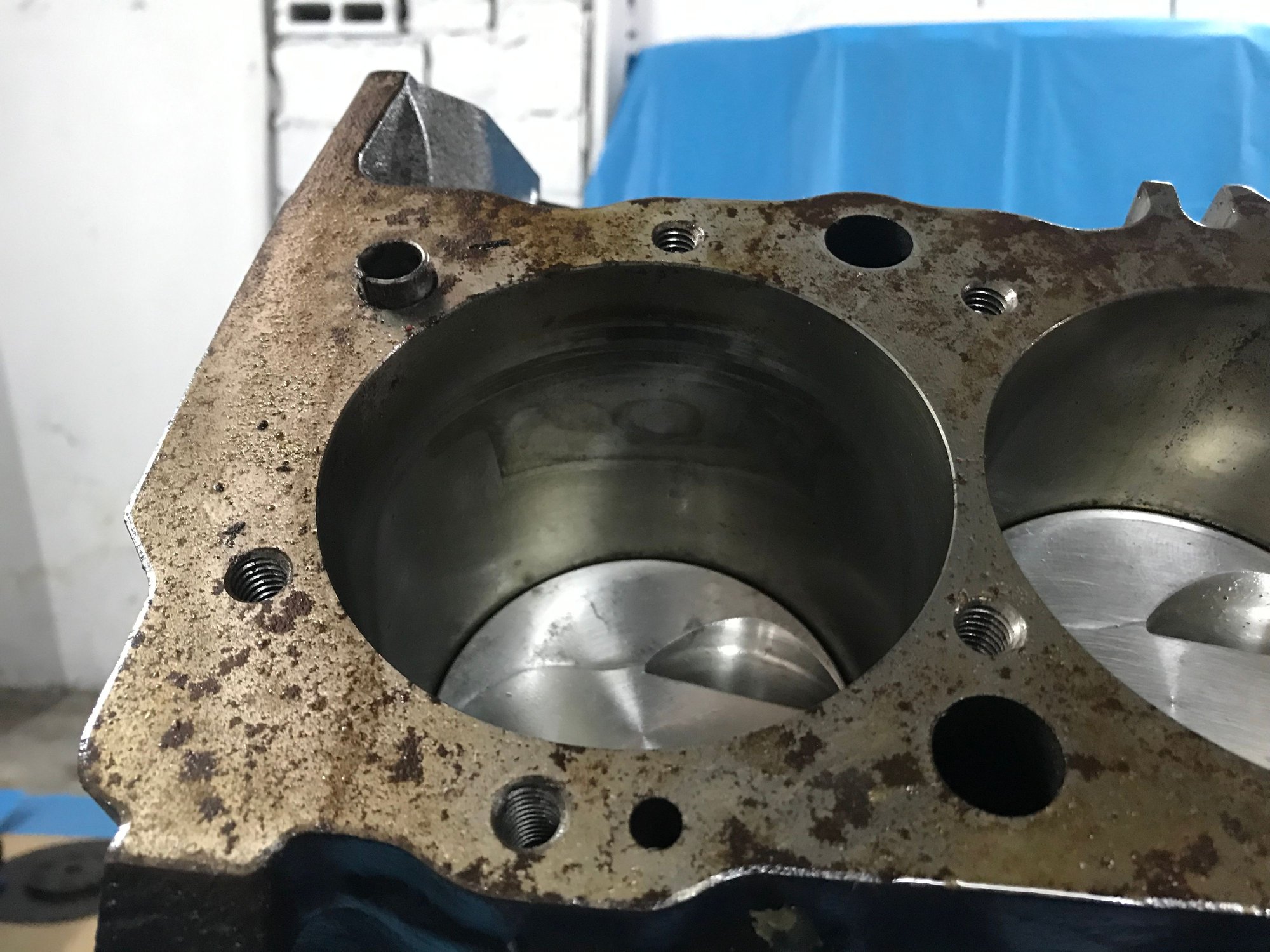

But first I disassembled the 582 spare short block and took it to the machine shop. It spent 5 years on an island and surface rust on the surfaces left some pitting. The cylinder walls showed marks where the the pistons sat all those years without moving.
It needs some skimming and honing.

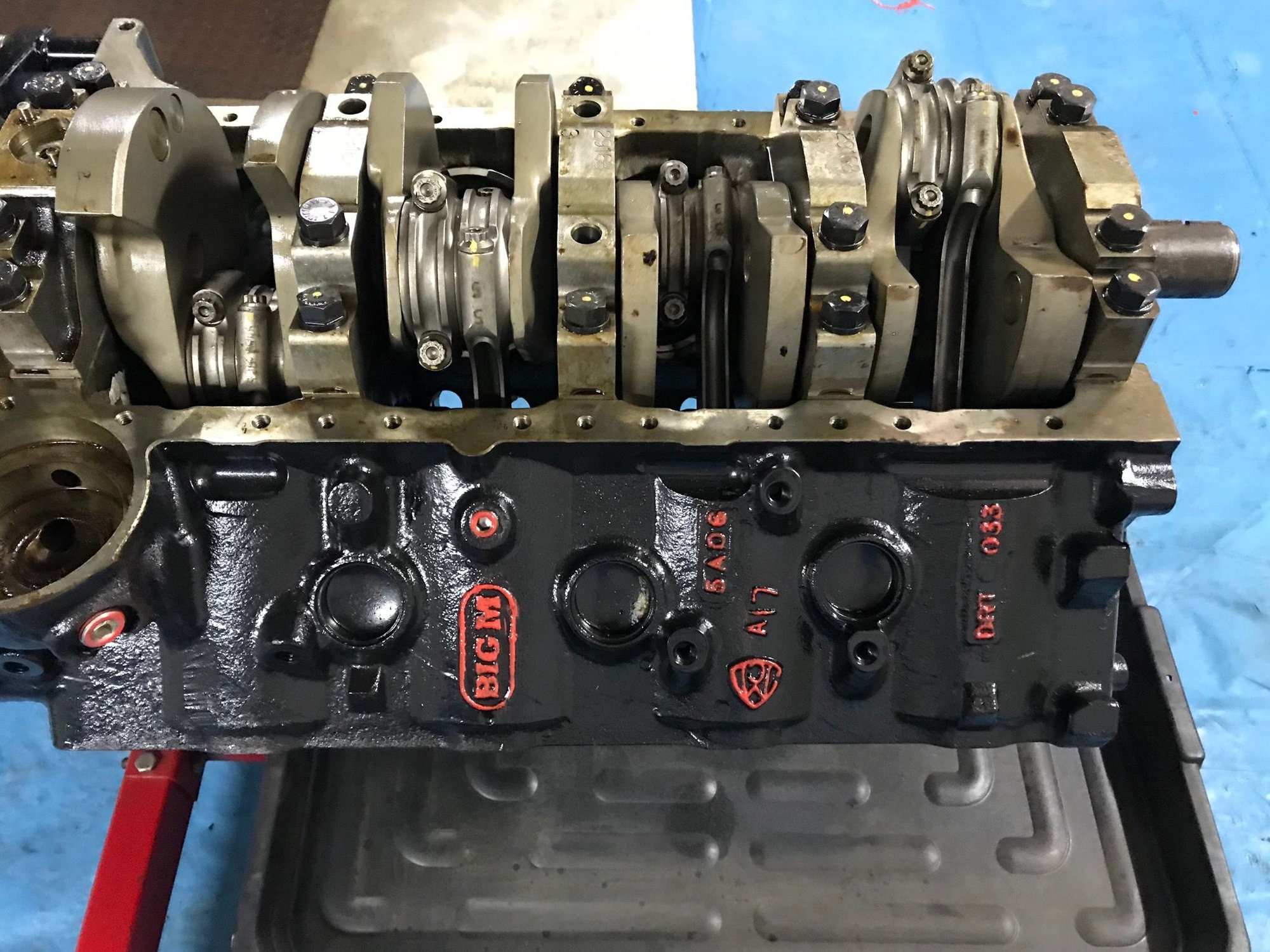

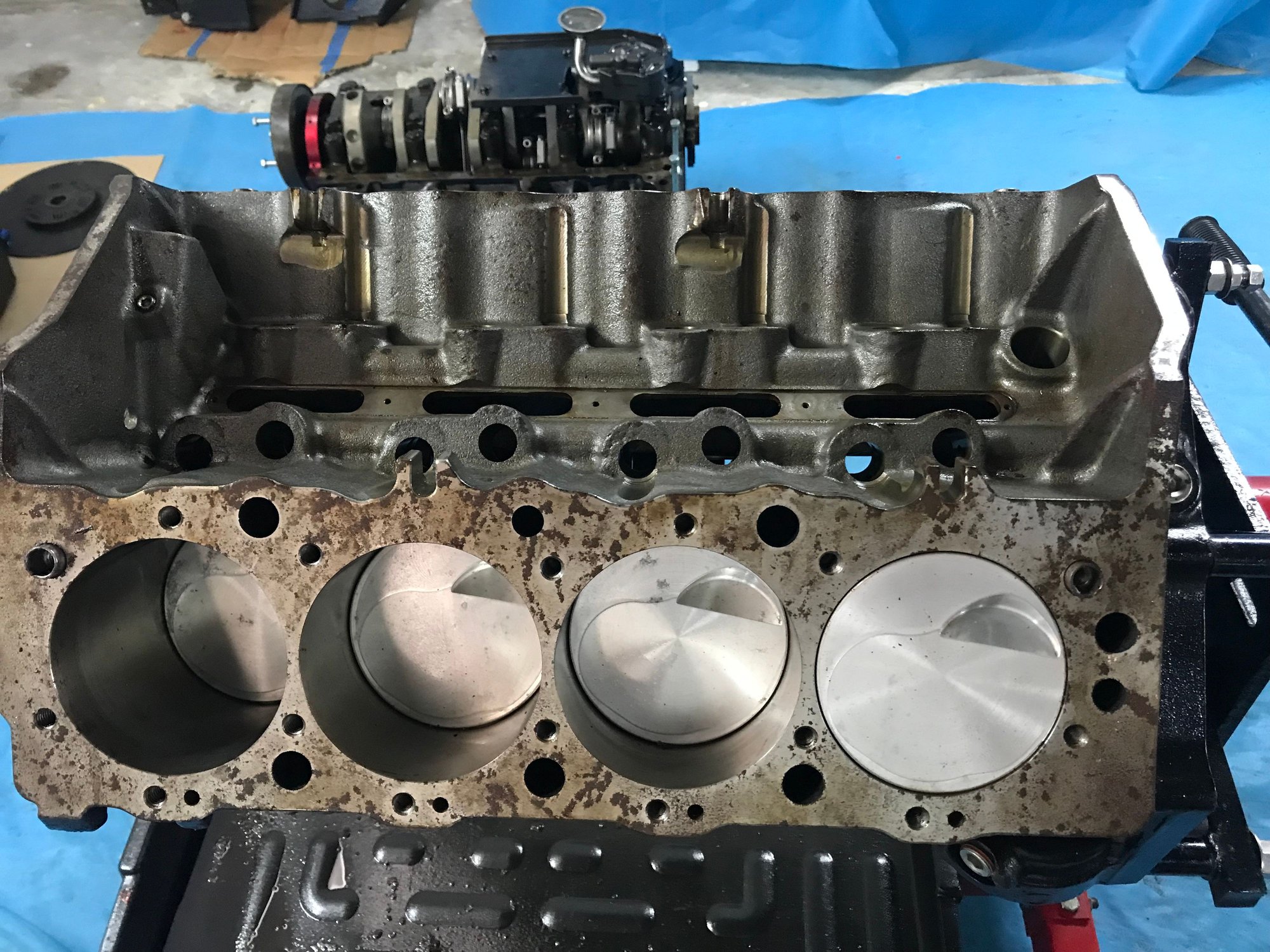

2015 Shafiroff 582 spare block zero hours
Couldn’t help to add some red paint. 3 main cap bolts were already missing when I bought the boat.
Pistons in front and heads are from the seized starboard engine

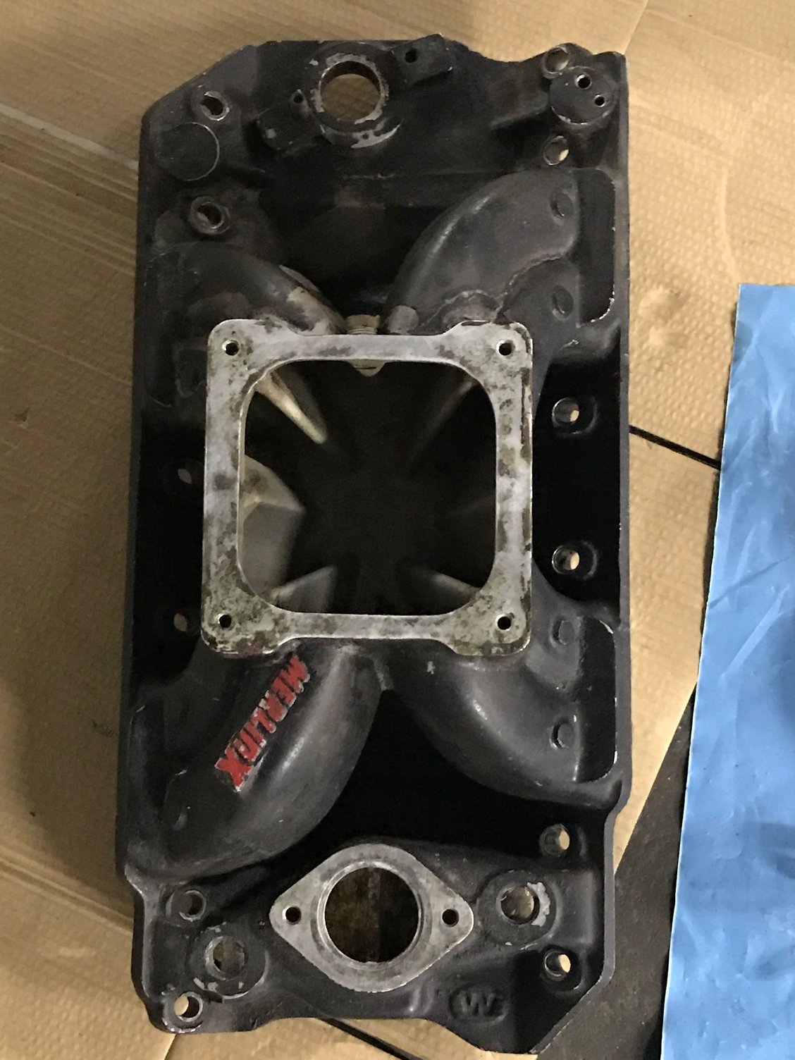

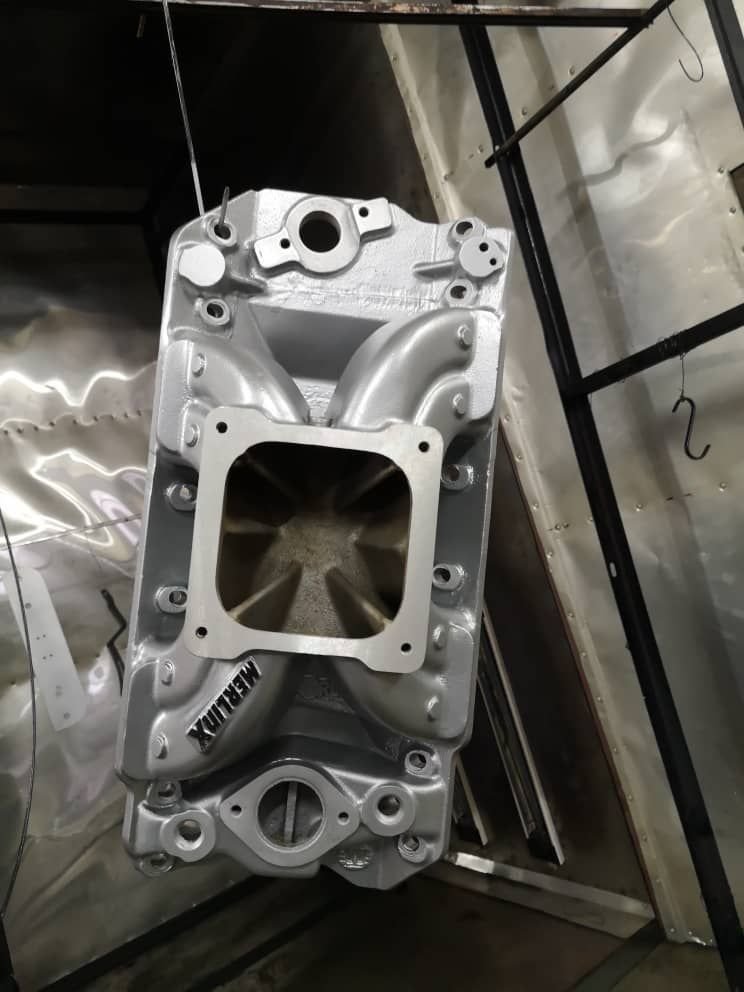

Had some parts blasted and powder coated and they came out nice

Originally Posted by AllDodge
Wow, bolts were missing. Never heard that one before
I also wonder why somebody would steal them, what for? As if there were other Dart big blocks around here.

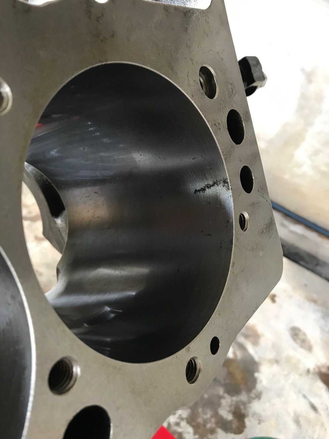

Progress is painfully slow, Malaysia is going through a series of lockdown and each time I canīt go to my workshop for a month because itīs just across a state border.

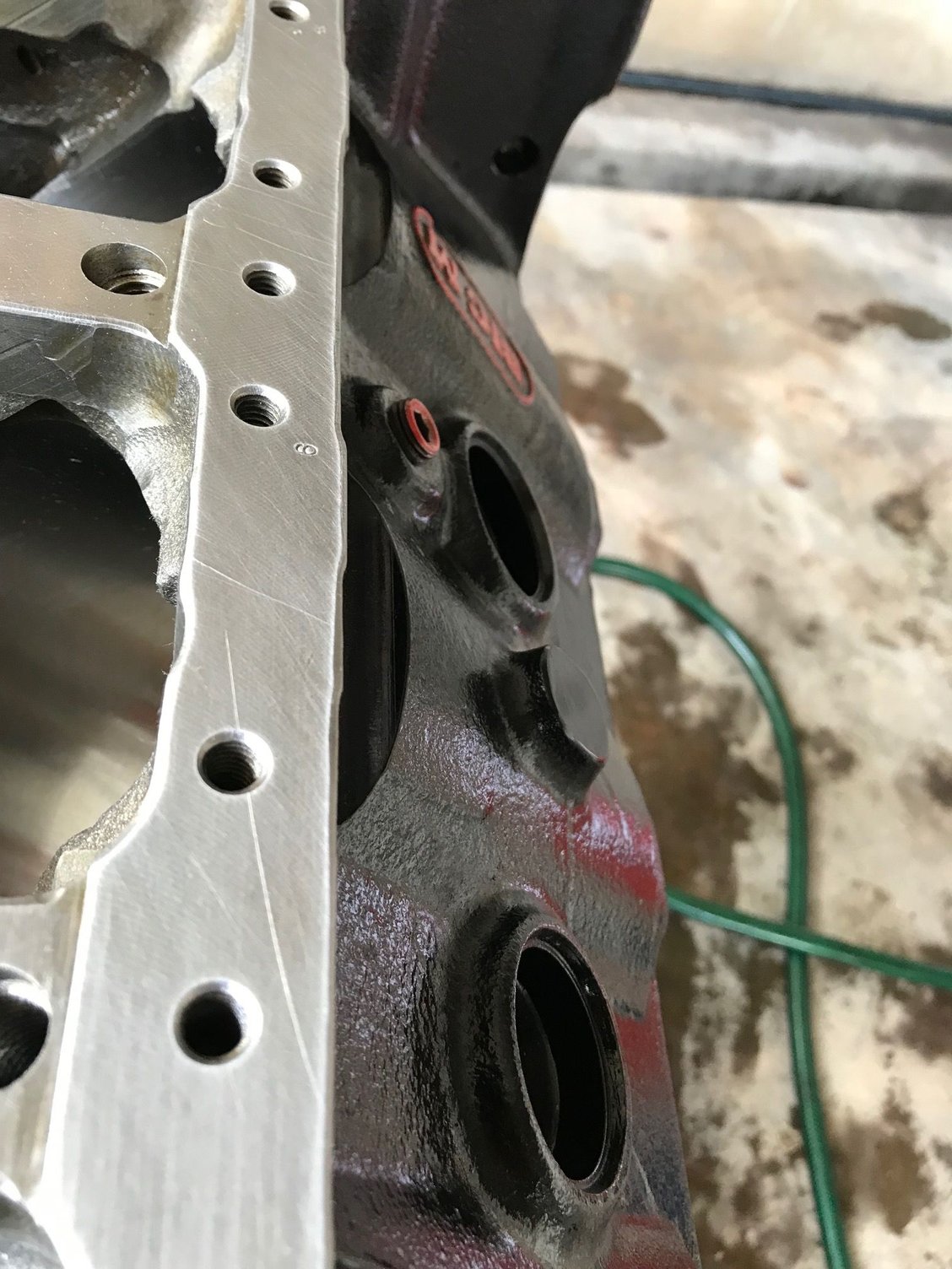

I got my engine block back from the machine shop and I was not happy with the result. They scratched the surface where the oil pan sits, will see if I have leaking later. They didntīt machine the deck enough to remove all imperfections and one cylinder wall even has a notable pitting, honing wasnīt that great either. I didnīt return it because I didnīt think they could do a better job.

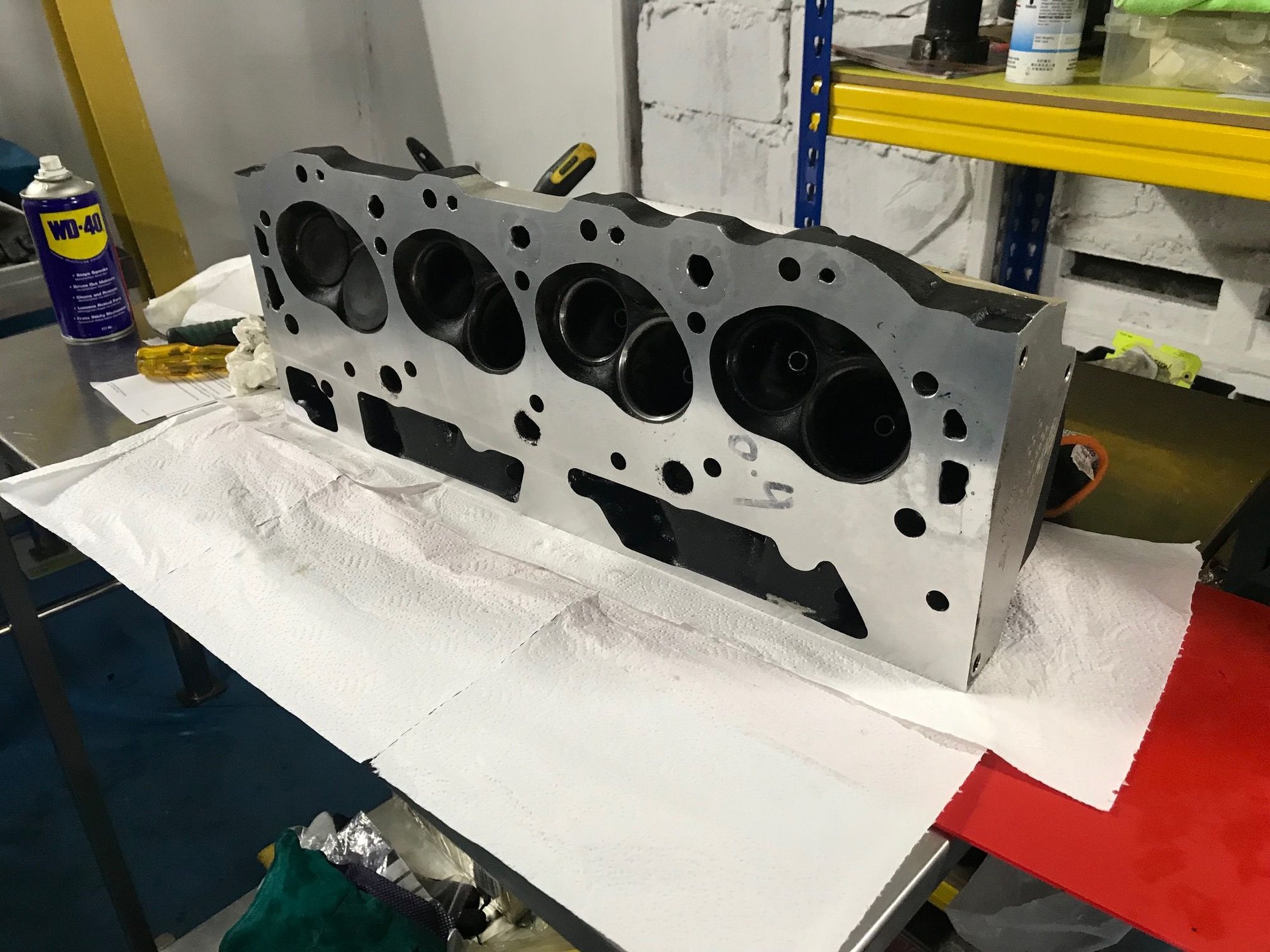

Cylinder heads turned out ok, given the damage they had. However they had to skim a lot and I would need thicker head gaskets, at least 0.060 compressed thickness. Compression ratio is already 10.5 and I donīt want to go higher. Problem is, thicker gaskets are all MLS (Multi Layer Steel) which need a perfect surface. As I donīt have that I had to go with the good old composition type and the maximum I found was 0.051. Talked to a guy from Summit who was quite knowledgable and he explained that skimming off the cylinder head counts for less for its conical shape. So it should be just fine, hopefully.
