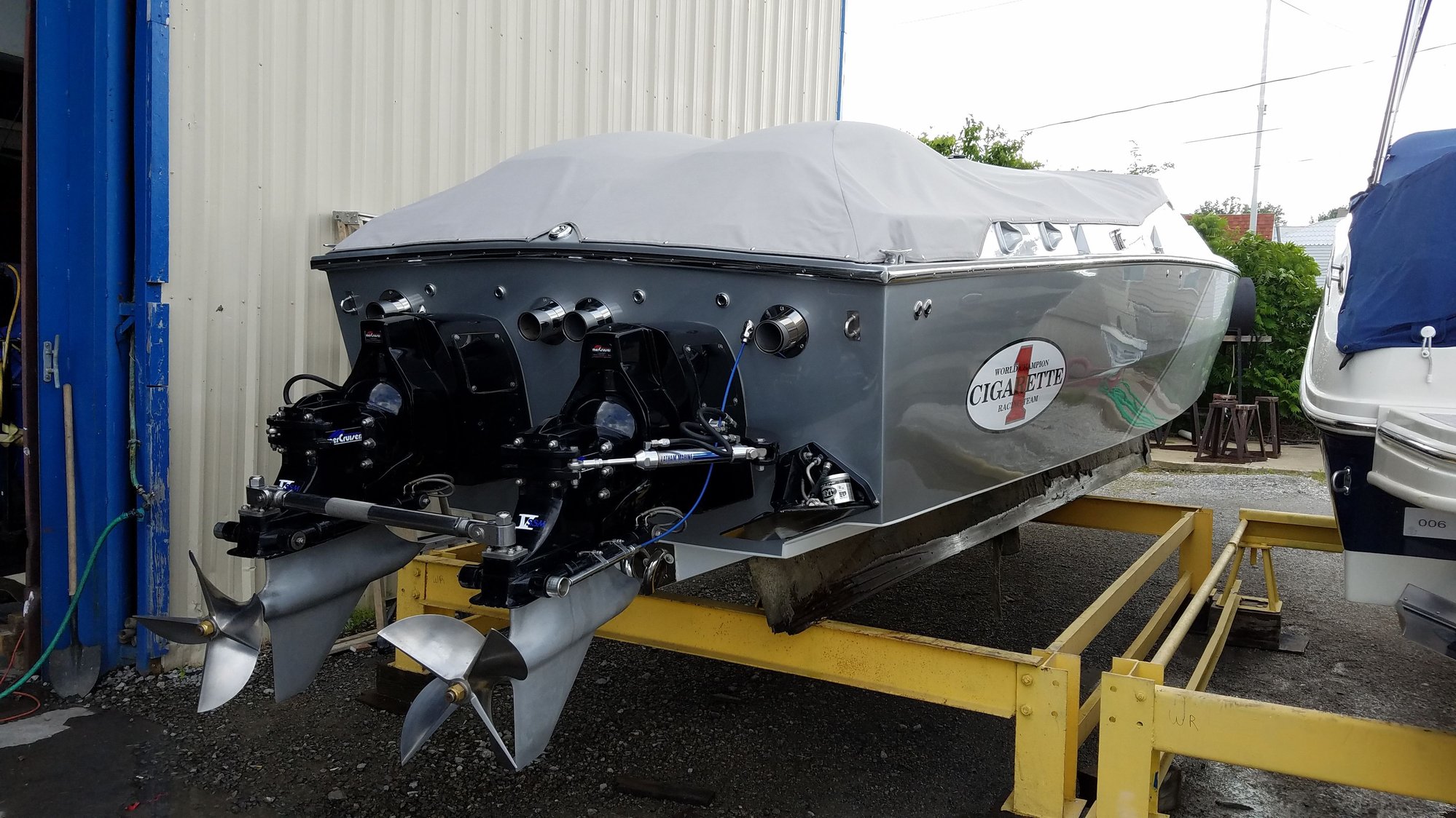

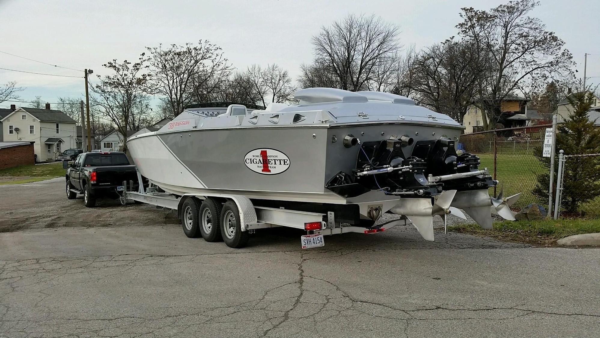

I have a fair amount of experience on this one.
1990 Gun with notch. Originally a TRS boat, then to Konrad, then to #5 SSM. Similar power to you, so all should be pretty even.
One thing you may want to seek advice on is that once you start piling up the spacers, sounds like you are going 3" total, this stresses the vertical shafts. May be a non-issue, but it's something I never thought about until it was pointed out to me by another boater / mechanic who works on the drives. I also have boxes, which give me more adjustability. I would say from asking around that on the older non-step heavy guns, you want that prop shaft 1" below the running surface. I was initially setup even, and it took all of an 18" diameter prop to even hope to get on plane, coupled with at a minimum, a 200# friend to climb up in the nose to get it up on plane.
I've tried no spacer ("even"), 1" & 2" spacer.
1. No spacer fastest, but there were times I couldn't plane and if you've ever come off plane in 4-6 footers in a bad area, this can be dangerous and possibly sink your boat.
2. 2.0" spacer, most usable but took off speed on the top end when spinning a bigger 18" diameter prop. I also could not get RPMs above 5100.
3. 1.0" spacer, this is the happy medium, so call the prop shaft 1.0" below the bottom of the running surface. It's still a little hard to plane, but more usable and speed did not suffer as much.
I hope maybe some of that helps to make your decision, also hope it saves you hours upon hours of messing with the setup and hardware changes.. These boats aren't super sensitive speed-wise to the setup, but more of a usability type thing. If you're full pleasure setup, and side by side engines, I honestly don't think there is a whole lot of speed to be gained by going to a surfacing type drive. It's more of a race boat setup and with super high drives, makes these things harder to operate. I would definitely do it again though, and would encourage you to go to a #5 or #6 drive.
Here is the setup.
