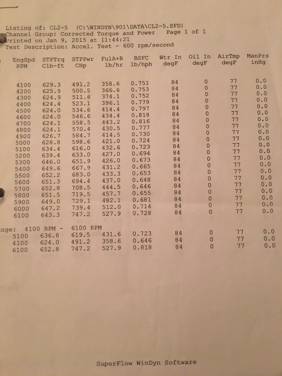

This is what I have for mine

So the engines were built and dynoed 5+ years ago???
Did you have them built?? How many hours on them?? What is timing set at and do you know what it was set at when dynoed??
yes, but done by previous owner. Not sure what they were timed at before, but I have them base at 24* and if I remember right 34* at 3000rpm
only a hundred hours or so on the motors, boat sat for awhile before I bought it.
