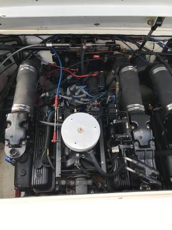

Find a reputable marine surveyor and have a complete bow to stern assessment. They do not always tell the real story of the boat but should find red flags (transom/stringer rot) etc.
The 350 mags are a decent, common motor that require yearly service and found in everything from this cig to sea ray day cruisers 350 Mags pushing a TRS is not going to strain the drives so reliability in a drive that is in good condition isn't going to send up red flags.
The issue with Salt water engines is they rot from the inside out, Again, you have to rely on a GOOD surveyor.
After that, its a used boat so you have to cross your fingers, but it is a CIG and they do live up to their reputation.

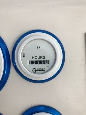

If not, they are a very desirable boat but be careful, it’s getting old. Recommend a marine survey, so much to check on a old boat. Engines, drives, electrical stuff and importantly, the hull. Need to check transom floor and stringers to see if they’re solid, could easily be rotten with moisture. Hours sound very low for a boat that age but nothing is impossible. Engines may have been replaced at some time or perhaps 380 hours since rebuilds...?
Have it thoroughly surveyed, they are classic old Cigarettes and worth owning but can also become very expensive if they need work.
