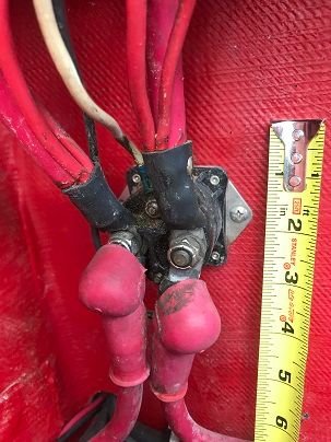

Back in high school (1974) I bought a 1965 Mustang. I learned to maintain and upgrade it using Chilton's manuals, reading popular hot-rodding, and asking fellow enthusiasts. Are there publications, such as Chilton's, for Cigarettes and/or Mercury Marine? I'm servicing my 1989 Cafe Racer and am running into a lot of unfamiliar territory. For example, what is this terminal block that goes to both batteries and has two low-current wires attached to it?

I`m going to say there is nothing like a chiltons for Cigs.
We`re your Chiltons
I pretty sure that is your parallel switch to combine both batteries.
There should be a parallel switch on your dash. 12v control voltage pulls in coil relay and combines both batteries.

Looks like a typical solenoid used to control high AMP circuit. functions the same as starter solenoid. Could also call that a relay too. The light gauge wires control the coil. Just google "solenoid wiring diagram".

Dan's correct, its your battery parallel solenoid. Some models don't have the switch on the dash, on my Top Gun it automatically pulls the solenoid in when you hit the start button or hatch.
Try and reach CIG3, he has the Cigarette manuals by model in PDF.
