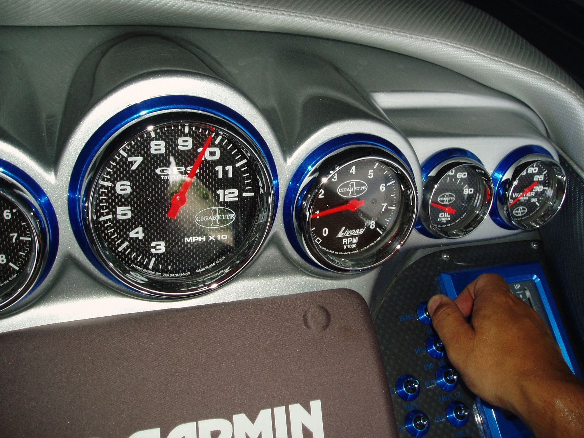

Just came back from seatrial and she did 97mph hitting the rev limiters with the 34 Bravo's so I'm thinking of trying a pair of 36's. Let me know your thoughts.
