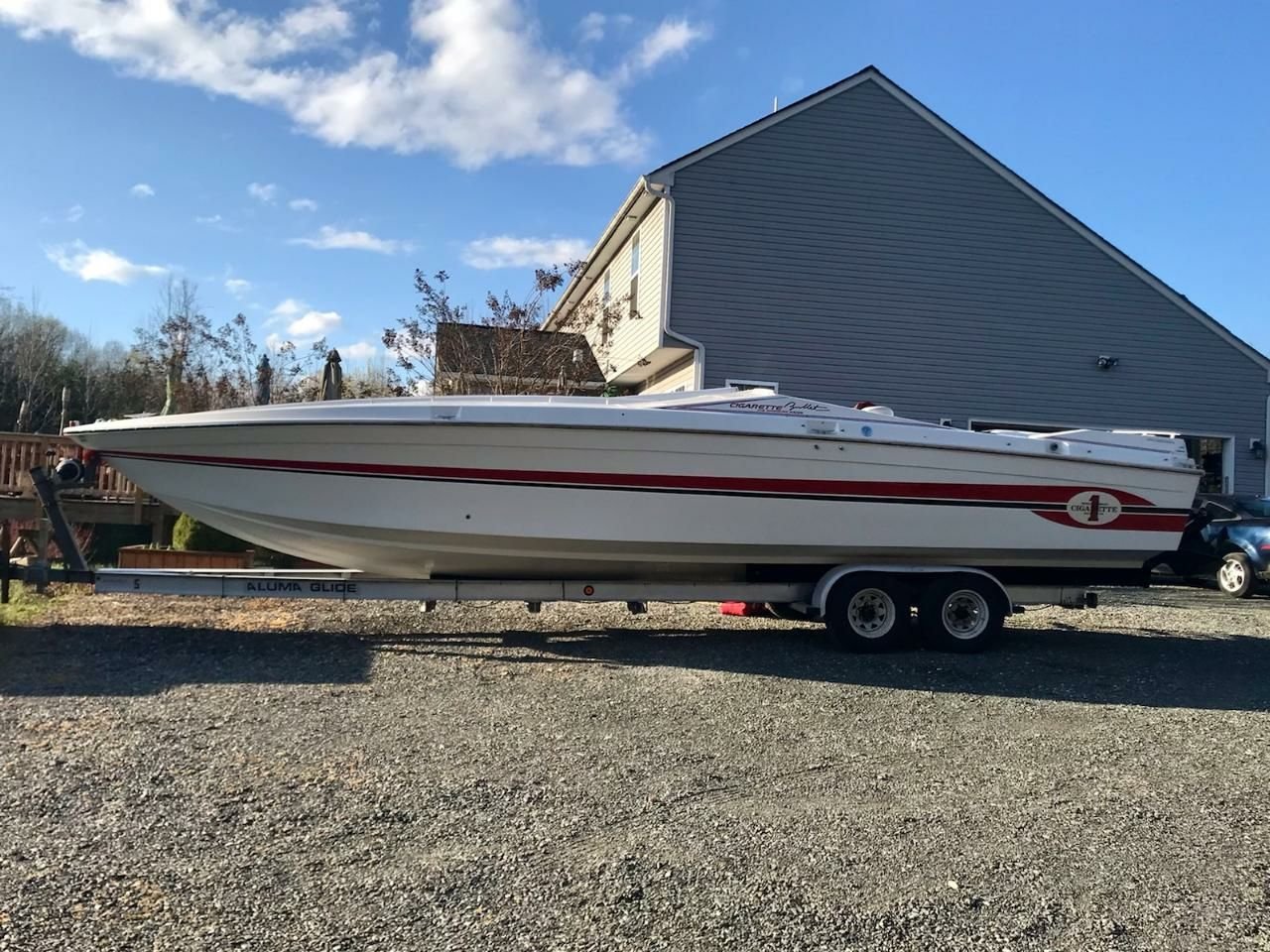

We bought this boat knowing it was a project. I'm a big time DYI type so it's right up my alley and that made the selling price attractive. The transom and stringers checked out, that was one of my major concerns. For a 32 year old boat it's in great condition, gel still has a nice shine. I wish it had a swim platform and hyd steering, but I can install later.

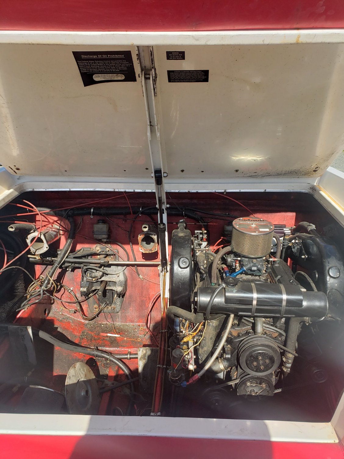

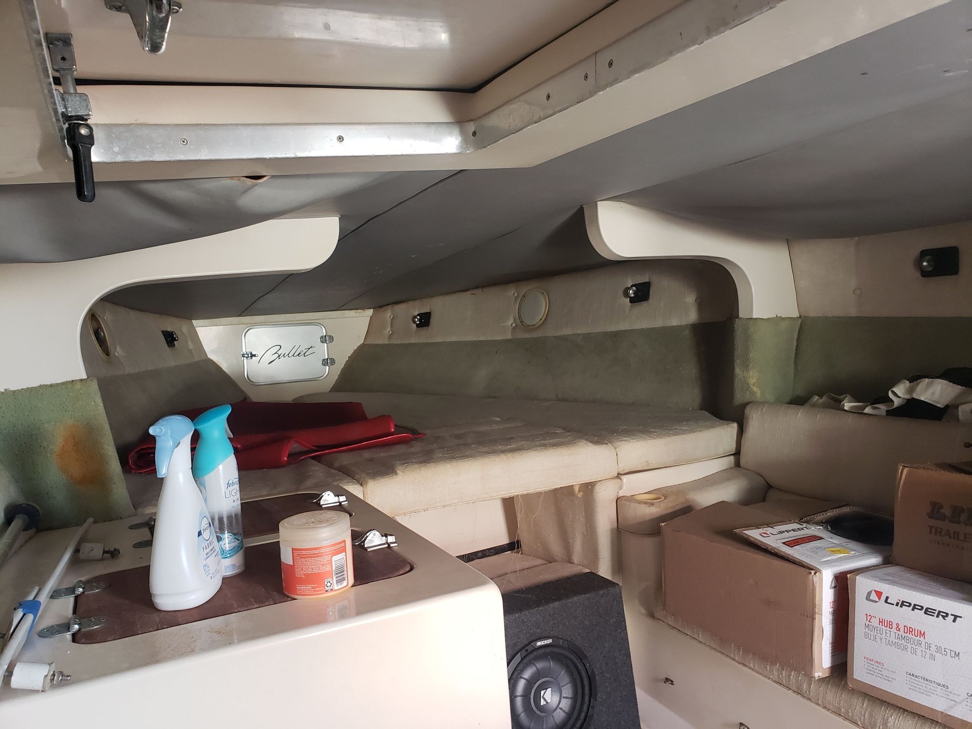

According to the flame arrestors, if they are accurate, motors are originally 425hp 502's. (Black motors?) Somewhere along the line he had them stroked to 540's. According to seller, port motor ran when he parked it, starboard motor had a valve train noise. He had pulled it, sent to to machine shop and it has been repaired. I'm not sure at this point if I'll tear it apart and double check their work. Port motor will probably come apart and checked out. I figured as long as the long blocks are in good shape, anything can be done from there. I'm not trying to set any speed records, just want decent and reliable power. The original cabin upholstery will need to be replaced right away, the cockpit upholstery is showing it's age.

We finally splashed it on Saturday and ran it a few miles across the river. All I have to say is -what an awesome riding boat. The power is there and it planed very quickly with hardly any throttle. After about 5 minutes at 2800 rpm I turned it around, headed back toward the marina and came off plane about a 1/2 mile out. Open the hatch to check for leaks and noises. No leaks, but the SB motor has this mysterious intermittent tap. Every 5 or 10 seconds it sounded like a cross between a ping and a loose lifter. It's definitely something in the valvetrain, but it was enough to shut it down and idle back on the other motor. (It's nice to have twins) I'm thinking maybe a roller lifer that is not happy anymore and ready to give up.
Since I have a shop with an electric gantry hoist, I'm just going to yank it out and do a full inspection on an engine stand. This is the motor that was rebuilt by the previous owner's engine shop and rode home in the back of my truck. This shop appeared to be a pretty reputable and I took a small gamble not looking inside the motor before installing it. Something like this may not have been detected anyway.
The port motor did have to come out and be completely rebuilt. After I got it home back in April, I ran it I found low compression on a few cylinders. Turned out it had a cracked head and had built up some rust on the cylinder walls.
