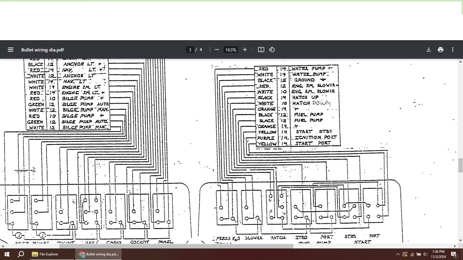

It’s not a separate switch on the Bullet. The starter switches have two poles that receive power when you press the switch. One goes to the engine harness/starter relay, the other goes to the parallel battery relay.

Found it/them. Turns out they are orange and must splice into a single white somewhere in the harness. I've been looking for a white wire. In the right column there is two "ORANGE +"
One taps off the hatch switch with a jumper to the port start switch, to connect batteries for hatch operation, the other is connected to the stb start switch.
The solenoid in my boat had no battery cables on it. Someone in the past must have bypassed it and ran direct to the battery selector switches. It did have the 10g wires to the battery charger though. Good thing I'm tracing everything out, the battery charger was charging the batteries via unprotected10g wires to the helm, then back through the master 10g wires to the circuit breakers on the battery selector panel. The connections were made at the bilge pump wiring. My guess is someone was having trouble with the bilge pumps and decided to run dedicated circuits from this solenoid.
