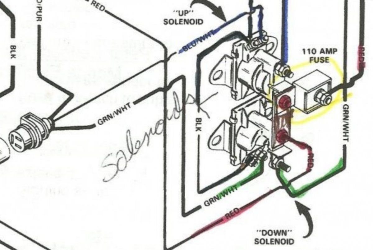

There is power to the pump through the switch because it will run when I hit "down" on the switch. When I hit "up" on the switch, I get nothing but a single click or clunk from the left, front side of the engine room. My pump for the engine hatch is under the dash next to the pump for the cabin door. I am thinking it could be a relay or solenoid that has gone bad. Anybody know how to test for this?
Jim Diesel 07-17-2024 06:25 AM
I'm sure they used a Mercury trim pump on the newer boats? If so and you have access to the pump, you could use a multimeter on the Blue or Green motor lead and have someone hit your switch to see if you are getting voltage out of the solenoid. If you do no have a meter you can take a jumper from the 12V+ (Red Wire) on the solenoid to the solenoid coil, might have a blue wire for up and green for down. That would rule out your switch and wiring. If it did not work I would verify the motor by putting a jumper across the solenoid post. More than likely it will be the solenoid.
