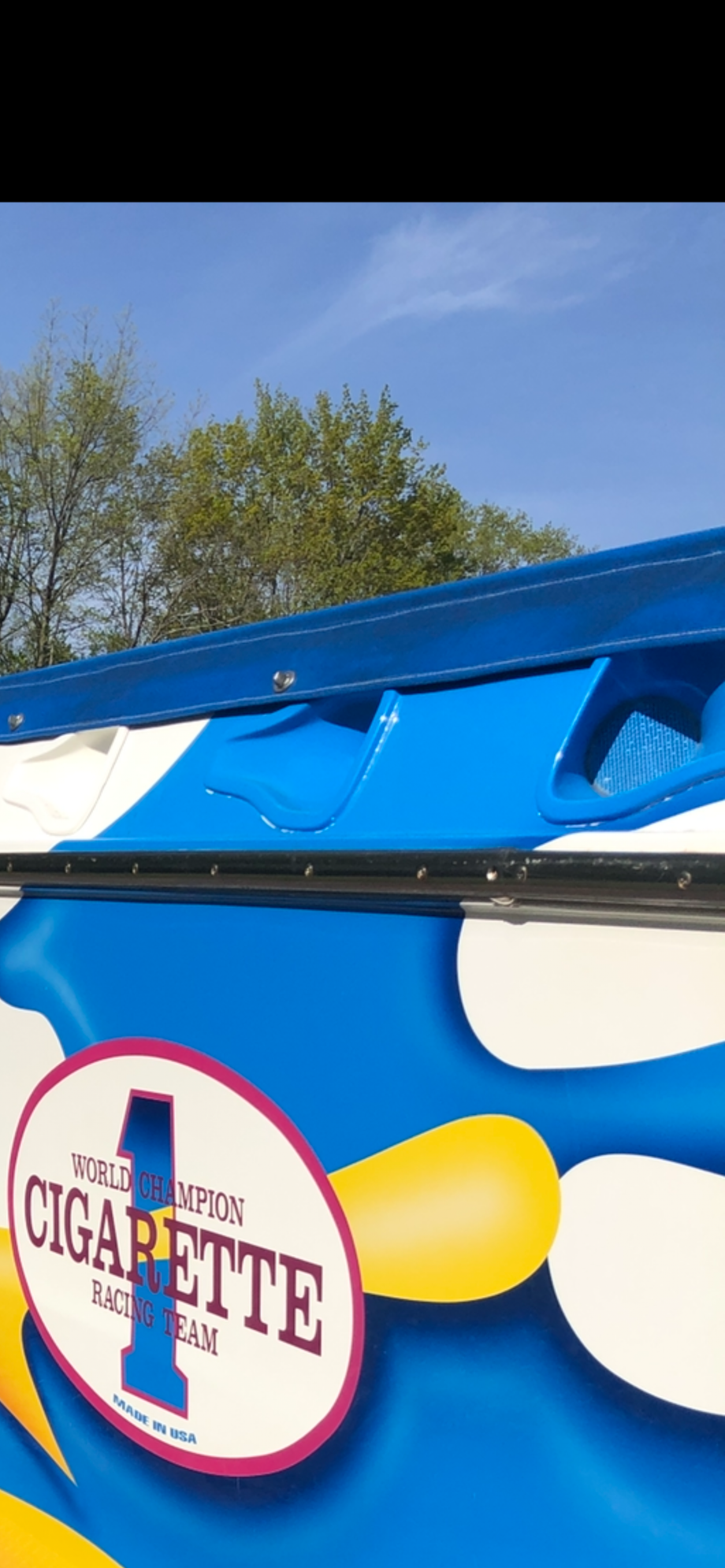

Any idea where to get vent mesh for older style top guns…are people just using stainless steel mesh now?
don’t think SS is paintable?

SS is paintable ...just needs to be prepped right. needs to be clean and a good self etching primer helps the paint get a bite onto the surface

Amazon has square sheets of stainless mesh. Could also try Dustin Carter, he might have something updated.
