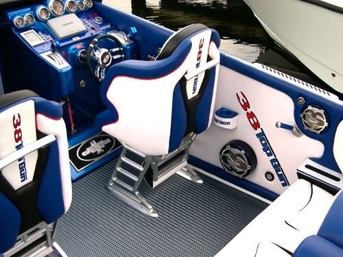

whats the cheese grator........

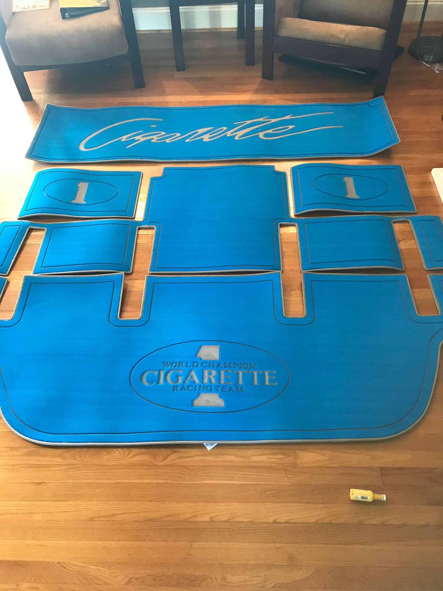

I just put Marine Mat right over my cheese grater (feet grader).
I have snaps on my foot rests, but I just laid the rest of the carpet in. Makes it really easy tp pull out and clean with simple green. I’ll dig out a pic.

those are fresh out of the shipping tube, they obviously lay flat once the sit of a bit
who’d you order through? Can I just call your guy and say send me a set in grey and red?! 😁
The pirelli floor
