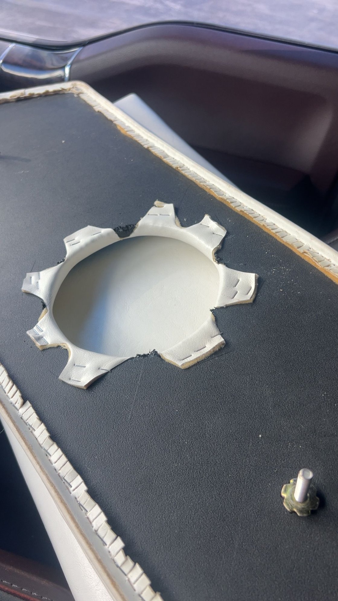

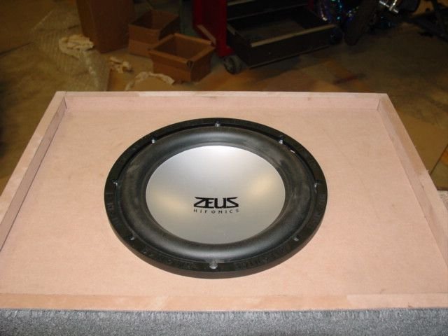

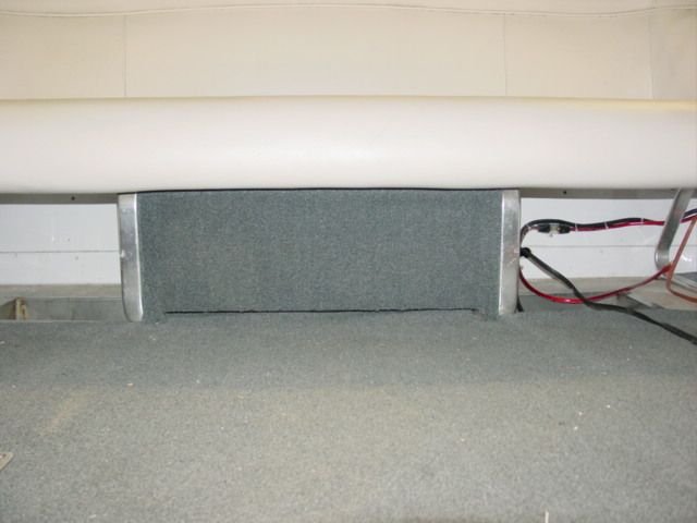

On my buddy's 28 Cig he had some crazy 6x10 square holes in the sides that he wanted covered up. Not sure what was there but no speaker or adapter we could find would cover it up. So we had some white plexy laying around...he had it covered in blue vinyl that matched the boat and i made some adapters for some new 6x9's :D Just get creative :D
Wally 02-25-2025 12:01 PM
https://cimg9.ibsrv.net/gimg/www.off...0ffecf9c93.jpg
https://cimg0.ibsrv.net/gimg/www.off...06209fa07b.jpg
https://cimg1.ibsrv.net/gimg/www.off...6e9e2368f0.jpg
Also made a small single 10" sub box for under the back seat. Totally sealed and down firing so it wont get damaged by stuff falling on it or people kicking it. Wrapped in outdoor carpet to match the floor of the boat and it was perfect. I know you Cig has a different back seat setup. If you have the room under the seat i would put to 12" free air subs in the seat wall facing the cockpit. Maybe install a wall between them to separate them but Ive seen them work just fine in the same space. If you wanted to get real fancy you could build or have some one build a forth order box...its a sealed sob box that fires into another chamber with a tuned port....so if measured right you could build a single sub box to place under the back seat and then just have a tuned port exiting into the cockpit...a bit more involved but out of sight and protected from most everything unless you store stuff under the seat :D

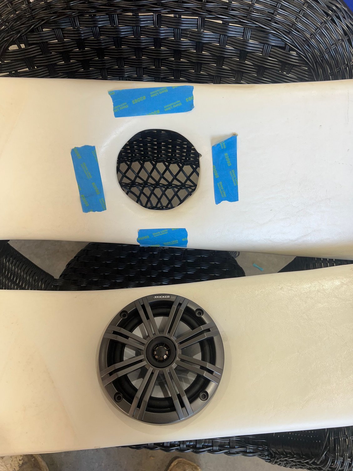

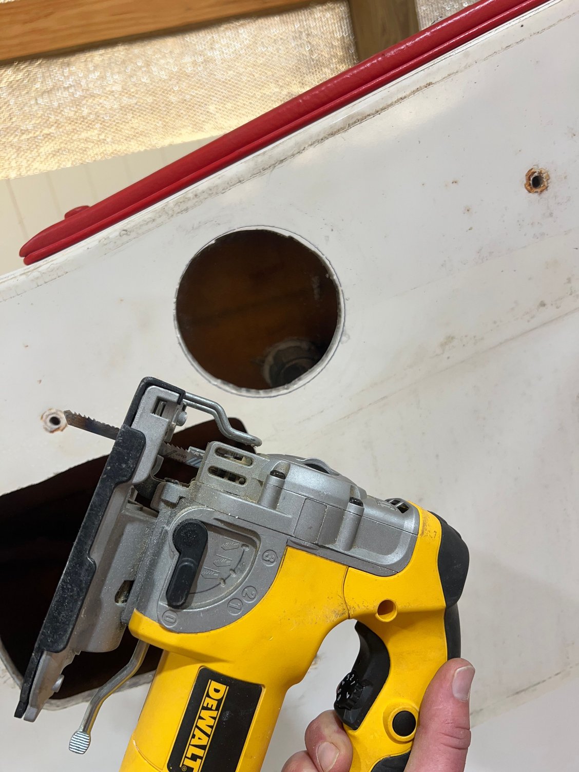

Cut
Friend of mine I went to high school with fired up an upholstery shop up in the last year or so. Dropped my side panels off to get the holes cut for 6.5’s in all 4 panels. I’m happy with the outcome
https://cimg4.ibsrv.net/gimg/www.off...d35afab87.jpeg
https://cimg6.ibsrv.net/gimg/www.off...ee9c1290f.jpeg
https://cimg7.ibsrv.net/gimg/www.off...c48ee9659.jpeg

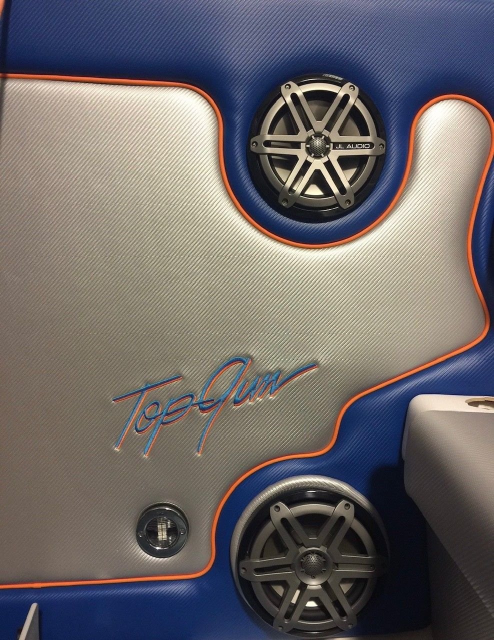

87CigCafe 02-25-2025 04:24 PM
https://cimg3.ibsrv.net/gimg/www.off...d66b29513.jpeg
did one 6.5 at the rear bench low and the one in front up high.

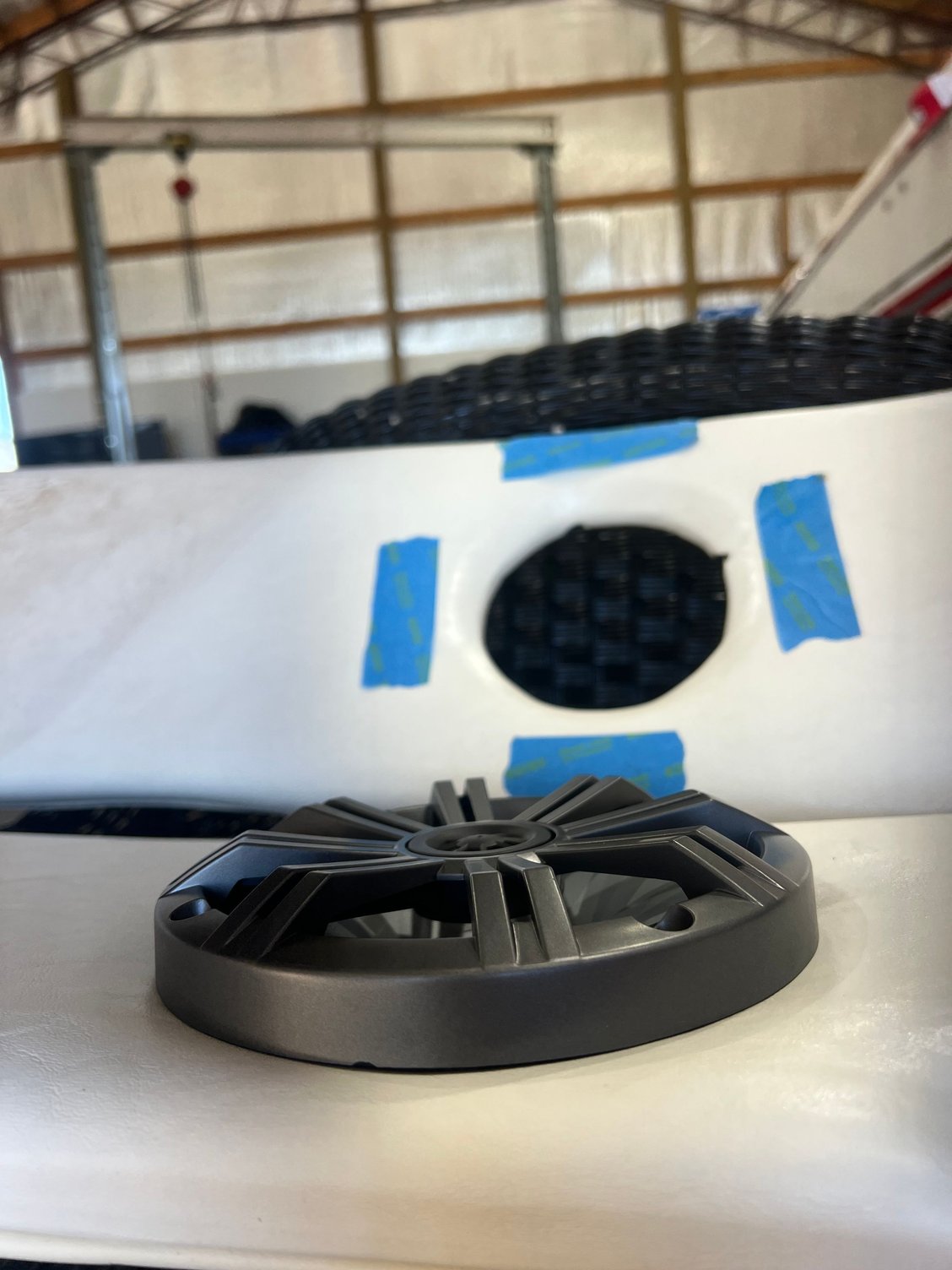

87CigCafe 02-25-2025 05:50 PM
Mock up.
Holes made and mocked up for photos
https://cimg5.ibsrv.net/gimg/www.off...e48241921.jpeg
https://cimg6.ibsrv.net/gimg/www.off...2dbdeb522.jpeg
