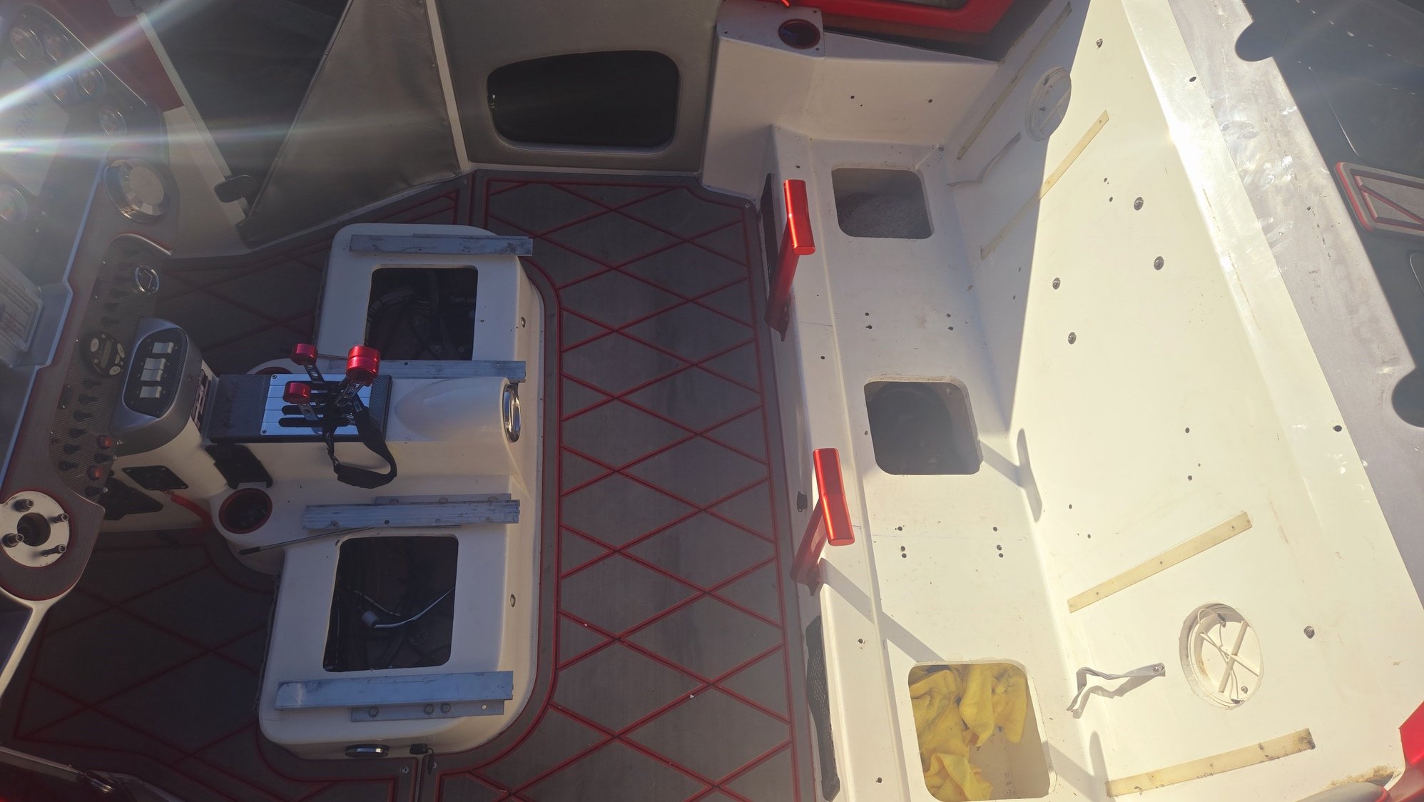

Where are you going to mount the subs? Under the rear seat? If you’re just going to slap them in there and not have them in boxes, you should purchase free air subs. Other options is have small sub boxes built behind the area you mount them under the rear bench. Enclosed boxes always sound better and have more of a bass sound or harder crisper thump. Open air is less “solid” bass. They mounted my 12” free air subs in the gunnels under the bolsters in our cafe. I wasn’t a fan. Rattled a bit and lost the deep bass. Our old gun had free air subs under the rear bench that sounded ok. Best sound is gonna be from an enclosed sub box. Our current hub has them. Nice deep bass. Hard punch.
Tank,
3 subs under the seats or 2 in the enclosures in the gunnel?
(each seat is basically an enclosure , all 3 are seperate)
https://cimg2.ibsrv.net/gimg/www.off...f48c33be0e.jpg
https://cimg5.ibsrv.net/gimg/www.off...8b0928bef4.jpg

Originally Posted by ICDEDPPL (Post 4920281)
Tank,
you could do 3. That was JL’s original claim to fame was running 3 subs in series. I’ve always just run two subs. Separate enclosures. I wish I hade a pic of the current boat. The speakers are in hard case (fiberglass maybe) angled boxes.
if you were able to use your rear seat area as induvidual boxes and run 3 subs in series that would be pretty bad ass. Only problem is cubic feet of air is pretty sensitive with speakers and then some speakers are ported and some are sealed boxes and it’s a science to get the best sound.
