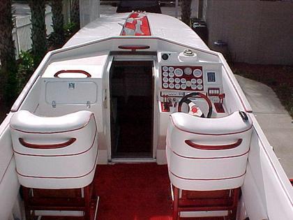

One I almost bought 2 years ago before I ordered teh Pantera, I still kick myself for not buying it.

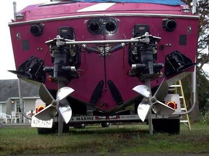

how far below the bottom of the boat would you recomend the prop centerline of a ssm#3 be on a cafe.
measured directly below the drive?

vette131
here is a picture of my cafe with #3's. the cavitation plate is about 3" above the bottom of the hull with the drive nuetral. they are usually mounted 3" higher than a trs.
