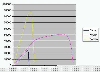

Originally posted by jmackin
Is there a difference between carbon fiber and kevlar?
Below are some property values for the three materials. Keep in mind these values are at optimum resin ratios.
Modulus of elasticity(stiffness)
Glass: 2,600,000psi
Kevlar: 3,100,000psi
Carbon: 8,700,000psi
You can see how much stiffer Carbin is than the other two.
Here are ultimate strengths for bi-directional woven fabrics:
Glass: 25,000psi
Kevlar: 51,900psi
Carbon: 87,900psi
Now, here's how they compare in terms of weight:
Glass: 0.072 lb/in^3
Kevlar: 0.061 lb/in^3
Carbon: 0.054 lb/in^3
Here are the strength to weight ratios:
Glass: 333,333
Kevlar: 850,819
Carbon: 1,627,777
You can see that Kevlar is about 2.5 times as strong per pound of glass and Carbon is about 5 times as strong per pound.

Below is a chart illustrating the manner which each material behaves when loaded.
The fiberglass is blue, Kevlar is magenta and carbon is yellow.
Note how the glass and carbon reach their peak load and then simply fracture. The kevlar begins to go elastic early and develops load gradually; the initial stiffness(slope of the line) is greater than glass however.
LS JR.
