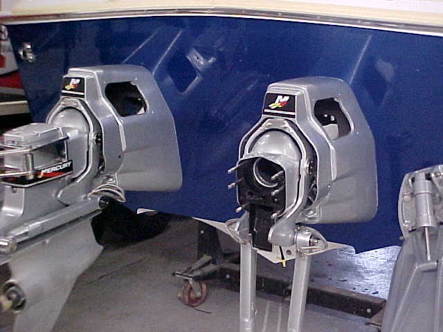

projects;
1999 38 TG 635 HP, oringinal speed 78 MPH after the box and some bottom work and one size bigger prop 82 MPH. X was raised 3 inches
2000 TG 500 Carb speed 67 MPH @ 5000 RPM , Modify bottom raise X 3 inch with box, one prop size up, 73.5 MPH
same customer ordered a new 38 TG we rigged it here with boxes and 575s ,94 .6 MPH @ Lake X
Plastered. came here @ 86 with 575s after boxes and some bottom work, 93+........
these are a few.
Boxes when correctly installed will help leverage the boat in rough conditions and allow you to run the extended tab. It will also have the drive back in cleaner water to make
the prop more efficient . Some bottom modifications may be need to change additude. You do need to keep after the driveshaft and bearing with grease every 50 Hours. To install correctly you will need to fill 4 inch part of the transom to raise the X and raise the motor 2 inches up and back to follow the degree of the transom. This will require new motors mounts relocated. The steering cylinders need to be relocated so fill those hole when filling in the X holes. You will need either a extended wing plate or extra long cylinders to make the steering connection also.

There is only one boat that I know of that didnt take well to boxes, a 357 formula, but it did handle much better. every boat will except it differently. Weighing the boat for center of moment will help you decide the X,The speed you will get out of the boat will be determinded buy not only the box but the bottom changes, and a good prop designed to work for that application.As you know we try to get the most out of all the boat for handling and speed , you look numbers the drangon has produced.
