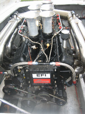

Here are some photos .

I have seen many of those motors. They were pure race motors, probably about 11.5:1 compression, race fuel motors. I can`t recall any of them that were put into a non racing boat at the time. Since they are 540`s I would say they were some left overs from the Miami New York record run we did back in 1982 or 3 ?????? Most all the boats used that combination, I ran a 46` Scarab triple V-bottom, did a lot of testing at Lake X to figure fuel loads, burns etc. Then last minute switched to the Gentry Turbo. motors. Most all the motors built at the time were 500 cu in motors to meet the open class rules, so the 540`s you have are great motors, Motors were configured from High deck GM performance blocks, usually we ran Brodix Heads, open chamber, incanel valves, Cranks were either Hank the Crank or Moldex, rods were Carillo. Motors should be bullet proof, I think we turned them 5,800 rpm. Randy Garcia over at Cobra engines in North Miami has all the parts you will ever need for them, Motors should also have the dual oil cooler bell housings. If so make sure you pressure check the coolers real well, probably should be replaced. Enjoy the motors, they are some of the best ever built. 7XCHAMP

They look like Can Am motors! They also look a lot like the photo of the motor that Top Banana is putting in the Benihana Cig. Beautiful stuff.
AEX, your boat is going to be amazing when the resto is done. I love seeing all this vintage heavy metal (and plastic!) come out of hibernation.
Is that a Kinsler injector set up that was converted to EFI?

Work will be concluded for next season . I can't wait . And yes those are Kinsler manifolds Merc converted to EFI .
