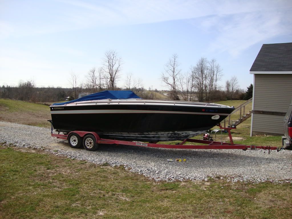

ill post some more updated pics tomorrow making good lead way on a budget this boat hadnt touched water prior in 5 years before i got it had it out a time or 2 once i got it .... had leaves over a foot deep in the engine compartment black tree sap all over it headliner gone carpet wore out and no interior the cockpit cover was layin over the engines when i got it...
thanks to all on the board ive bought parts from to make it possible... gonna have 2 real nice engines for the boat with everybodys hand me downs.. plan is to use the drives this year i plan on being easy on them just want to get back in a big boat this year been with out for a year feels like forever when im just 4 minutes from the water im gonna do a run down on parts as this boat was what i wanted but the power wasnt desirable... so i weighed the costs between swaping it or rebuilding them and not being happy came in close enough to pull off the swap.... some parts where not needed but wanted by me

have already done all the new carpet and headliner have roughly 500-600 in that have the bolster seats and rear seat done around 800-1000 on them have a few more interior peice to vinyl thats later on working on gettin it running
short blocks are assembled and on stands waiting for rest of parts hopefully there here by friday ill have complete engines before the weekend over..
ill need more stuff here and there before its over but not doing bad for having one completely gone threw of course could have bought one already done if i had all the money at once.. what fun would that be..
still need to catch a few good days and finish the bottom paint of the boat been raining everyother day around here
went threw all the old wiring an removed all the garbage that was installed threwout the years
someone bypassed alot of stuff as i assume they didnt know how it worked sad thing was all factory wiring is good i rewired it all back... have to figure out what im doing about the new trimpumps and oldswitch setup still
took the old shifters out and installed the new ones had to do some cutting pending pics..
tryin to keep it oldschool with a few updates..
best part off all itll be one of a kind and paid for when done.. i dont know of any other around my parts.
pretty bad ive sold off 2 other boats to fund and cut down on projects to get this one done..lol
something about the sound of twin v8,s
thats proof for all the young guys you can do it just keep your head with it i got this boat about may of last year
99 percent of work was done by me here at home
figureing 10-14 in it when done wont be far off
i traded a motorcycle worth about 3500 for it when i got it.. that includes that as well
