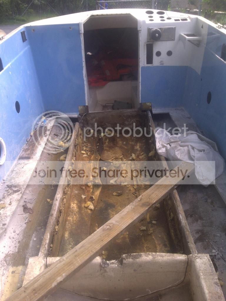

since you are redoing the boat, the stringers on those boats don't run all the way to front of the hull. They stop like in the beging to middle of the cabin and if they are ran hard, it has the tendency of delaminated in that area. Take my word. i owned this one serveral yrs ago and it happened. I ended up running the stringers all the way to the front of the cabin. http://miami.craigslist.org/mdc/boa/3306478108.html

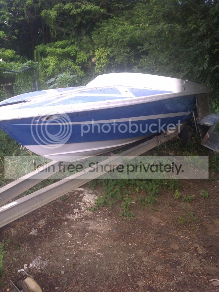

Here are a few quick pics of the boat under work will update my progress as i go along
the top floor had been removed the gas tank removed everything out!
Removed the bracket from the stern next weekend will start the sanding progress any ideas for paint open for anything!!!

Thess boats were built from the 26 Martini Mold
They were also building a 24 Center Console that came out of the same mold but with a spacer and different Deck.
Very similiar to Pantera, Carrera, P&D and others if not the same.

I've know Jorge Guia for 20 + years. He's a good guy and a good FRP man. The avengers were made from the P & D molds. Jorge also had the 31 Sunshine/ P & D hull mold that I ended up buying (then sold them to Gito at Zero Tolerance) The avengers were built right next to the 25 Active thunders. I set up Jorge with Pat back in 97 when AT was overwhelmed with orders. The other partner (silent) in Avenger was Peter Roca who now has a big shop in Opalocka. Jorge is not in boats any more.
