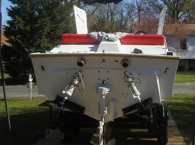

anyone know how the trim tab system is working i see on both sides 2 electric engines behind the gasoline thanks,not easy to reach on both sides is a + and - cable coming out.
dont see any hydraulic oil reservoir.
on both side in the engine room is a electric plug (attachment 2107) ?
start step by step ti try to understand what is what.
thanks in advance !

those are the hydraulic trim pumps for the trim tabs and drives, the 9 pin plug in your hand is the engine electrical harness that plugged into the engine for your dash wiring . the oil reservoir is under the pump motor the square bottom.

The same pumps I used for my trim tabs (the 24 is an inboard). Just simple Mercruiser trim pumps. Easy and cheap. Should be a flat blade screw in the corner of the square lower half to fill with motor oil or transmission fluid depending on what they used.

The actual tabs them selves were made for me by my friend, Mel Riggs and have his initials on them. He used just standard hydraulics from Mercury.
