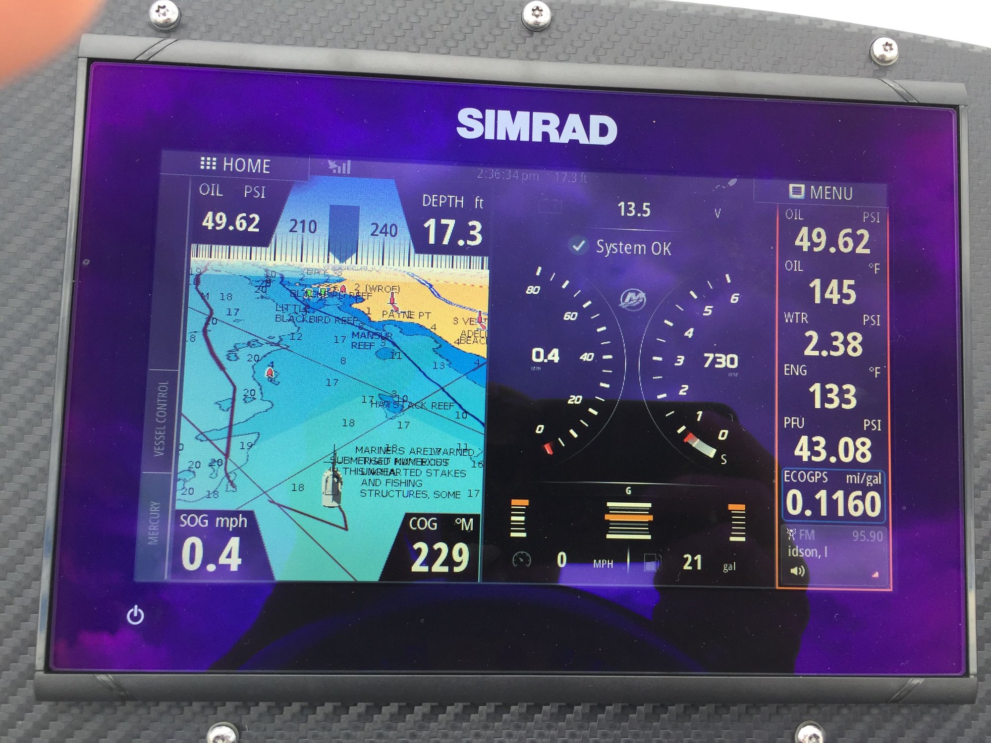

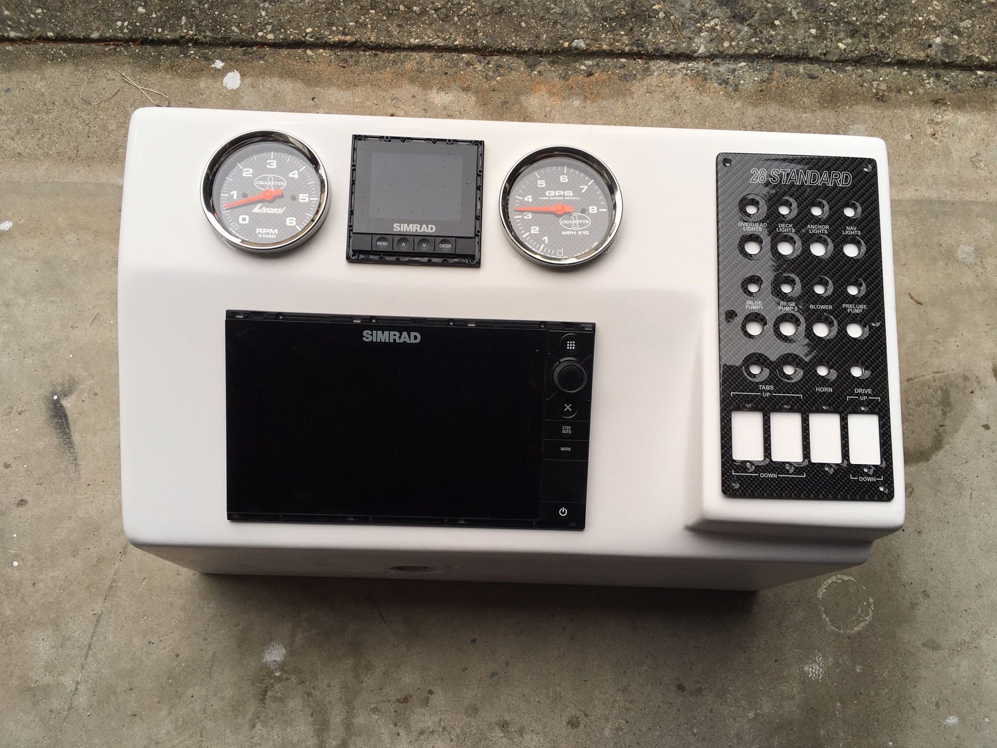

Depending on how much time and money you want to commit you have plenty of options. My set up is a sort of hybrid one. I'm working with a tiny dash for an old Cigarette 28 Standard. I wanted to integrate a full function GPS unit without it looking like an add on so I went with a Simrad NSS9 to display all other gauges except the speedo and tach. I have a Simard IS35 to act as a backup instrument display and fluxgate compass display. There are manual oil pressure, fuel pressure and coolant temp gauges on the engine for backup.
For non-digital engines there are converters on the market to analog sender signals to NMEA2000 or other standard digital signals that can be used by most modern full function GPS units. The one I'm going with is called "Noland CANbus Engine Data Converter". It can convert all engine data plus tank levels and trim levels to digital signals.

70open28, who did the side switch panel? Very nice!
CDShack is offline
Old 09-12-2018 | 02:43 PM
Joined: Jun 2011
Posts: 136
From: Severna Park, MD
Livorsi Marine. I had them do it to match the carbon fiber faces on the tach and speedo.

Upgrading/redesigning an instrument cluster can be agonizing. Whether or not to maintain originality or go with new technologies, there's a lot to think about. I think the highest priority is for functionality and reliability. I originally planned to go with all analog gauges and a GPS unit in the center but as I drew up the options it was clear the dash was going to be very cluttered. That's when I looked into using the GPS display panel for most of the engine monitoring and the trim display, I have digital trim senders on the tabs and drive. Going digital allowed a cleaner set up and opened lots of display options. I can also control my audio system (Fusion Audio) from the GPS unit. But as I stated before, I do have manual gauges (Marshall gauges) directly on the engine for reference.
As for the switch panel, it was not cheap. Livorsi's custom work is very expensive but top notch. My panel was $450. I could have gone for a cheaper solution, there are several custom panel sites, but I wanted the panel to match the face of the LIvorsi gauges.
