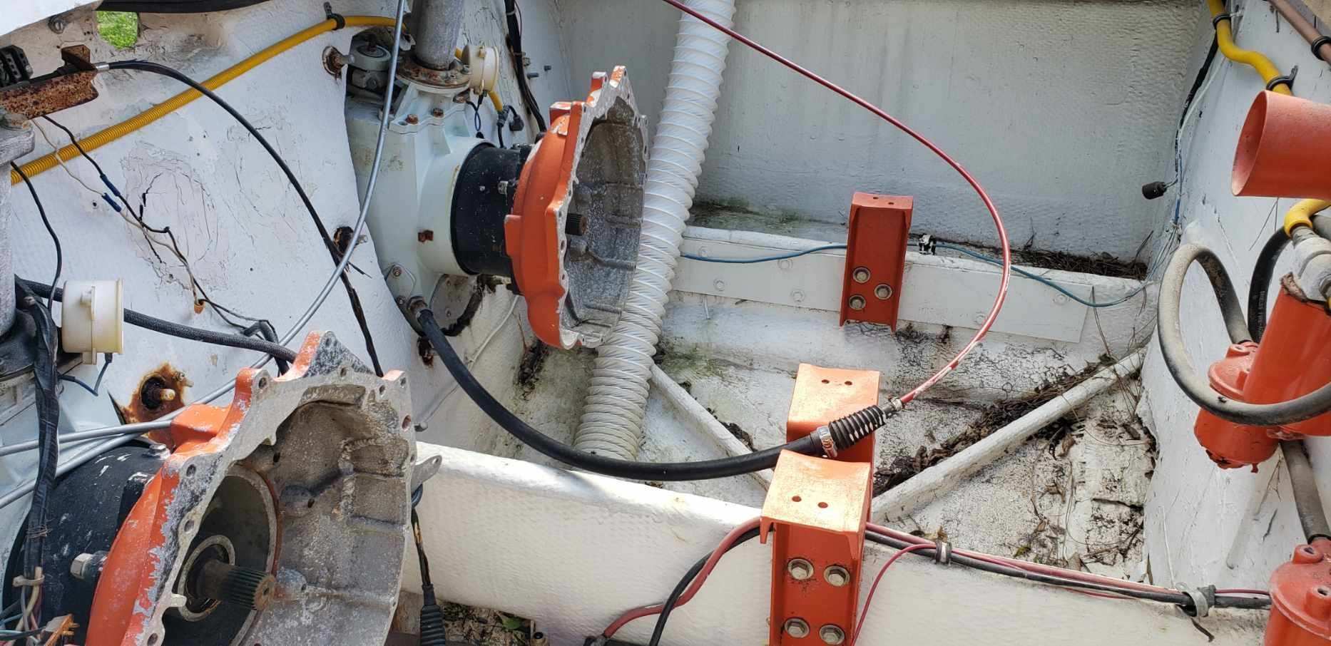

They both appear to have a hydraulic ram at the base of the transom mount, that recesses into the bottom housing. Both are retracted all the way in. There are separate switches and gauges that are labeled as trim also, one of each for each drive. The serial number on one Drive I believe is: Pz nr 2179908. Other one is missing. I guess along with identifying which drives these are for trim and parts purposes, it would be nice to hear opinions on their compatibility with different power plants. I have the bell housings, and they look like others from SBF’s. Is it possible to switch to a SBC with these? Different housings available for them? Thanks again for the input!
Way back when Merc used the Ford 351 block for some of their I/O packages. The bell housings were different than the ones used in the GM based engines , so I don't think that they're interchangeable in any way and thusly that would apply for the Volvo applications also .
From the pics you've supplied so far those are NOT trimmable Volvos. If you do have gauges that refer to the outdrive position they are more than likely the tilt/lift reference gauges.

As mentioned earlier , the pics you have posted show the non-trimmable 250-270 transom plate. No large 'elephant ear' trim mechanisms in sight . As a matter of fact you can clearly see the manual (and fixed) trim pins ! You mention these gauges for trim , can you put up a pic of them ? I'll bet anything that they're the standard tilt/lift indicator gauges.
The pin that actuates the tilt/lift mechanism is visible on the top of the transom plate just inside / above the steering helmet. When retracted it only looks like a large washer slightly protruding from underneath the transom plate. When activated it pushes down like an oversized nail and releases the locking mechanism allowing the unit to tilt up . It is purely an electrical device ( I believe a Bosch motor) and is not hydraulic at all.
Unfortunately you don't have any pics of the transom looking from front to back but if the tilt motors are still there they're on top of the inner transom assembly with a black plastic cover over them that's held on with a single top mounted screw .
Very curious . I can see that there's no internal steering arms as the boat has external hydraulic steering but all the pics are just cut short of where the tilt/lift motor should be visible. It ought to be on top of the silver colored shaft thingy coming off the top of the internal transom plate/housing. (And btw, they look to be in nice shape too)
I can't enlarge the pics of those gauges but they don't look like the OEM Volvo tilt gauges and of course the switch looks like it's long since gone kaboom so we can't use that as a reference. If memory serves me correctly the original Volvo lift/tilt switch was a simple single rubber boot encapsulated toggle switch. Up or down , nothing else.
Also interesting that as a 'performance' boat you believe that it had Ford V8s in it but it doesn't have through transom exhaust .

Check out the bottom pic. There’s definitely some stuff on top by the “shaft thingy” but not sure what it is. Also in bottom pic, you can see where the old through hull exhaust holes were. Someone patched and glassed them in for who knows why. It really is kind of an interesting story with many missing parts. I also agree in that there’s definitely some aftermarket and add on stuff that probably wasn’t original.
It would be interesting to see a picture with one of the outdrives lifted up and a look at this ram you're talking about as being at the bottom of the housing .
Now here's a what if.
Is there a chance that this boat was originally powered with Mercs and it was converted over to Volvos ? Two reasons I ask that . One , those gauges look like they could be very old Merc trim gauges and the thing you say is the remains of a switch could be an old Merc trim switch .
Two , the outdrives appear to have spacers on them to get the prop shaft deeper in the water . I can't recall ever seeing these before on Volvo units. Is it a possibility that it WAS once a Merc boat and the person re- rigging it just cut the bigger Volvo holes around the old Merc holes and then found the unit wasn't deep enough after the fact ?
