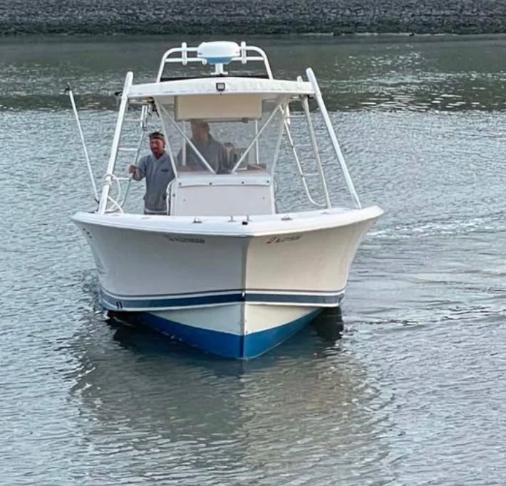

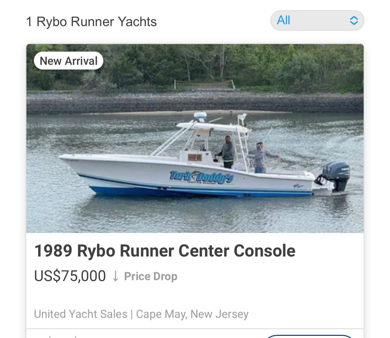

You’re not going to hang twin 300s off the back of that 24 foot cat much less add an additional 500 pounds in diesels . These skinny hulled Cats have very little buoyancy aft compared to a monohull.
As good as the cats ride a 24 foot cat isn’t going to ride better than a 30 foot v bottom in anything over 3 foot . Cats do eat up the light chop but I’d take my old parasail boat against a lot of boats in a 3-5 slugging through them at 16-20 mph.
My boat was an Ocean Pro 31 but it was a copy of the old Rybo Runner with the step taken out of it . Find a Rybo Runner and put a big diesel in the back with a v-drive and a Arneson with a giant swim platform on the back of it to cover the drive if your sold on diesel.
check this out. https://www.yachtworld.com/yacht/1989-rybo-runner-center-console-8342831/
