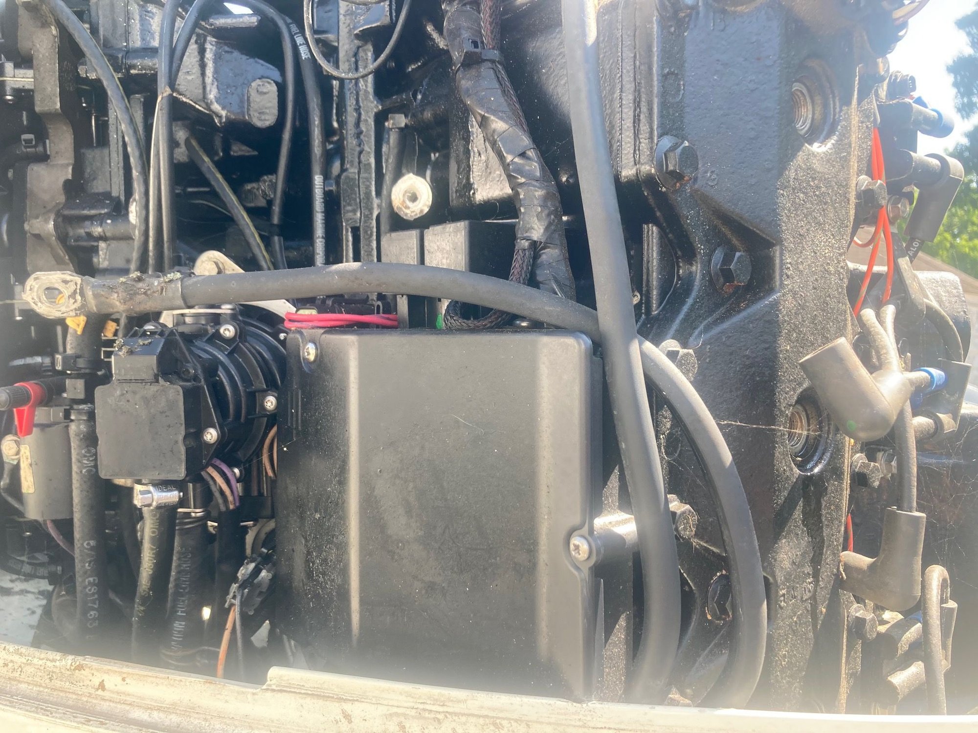

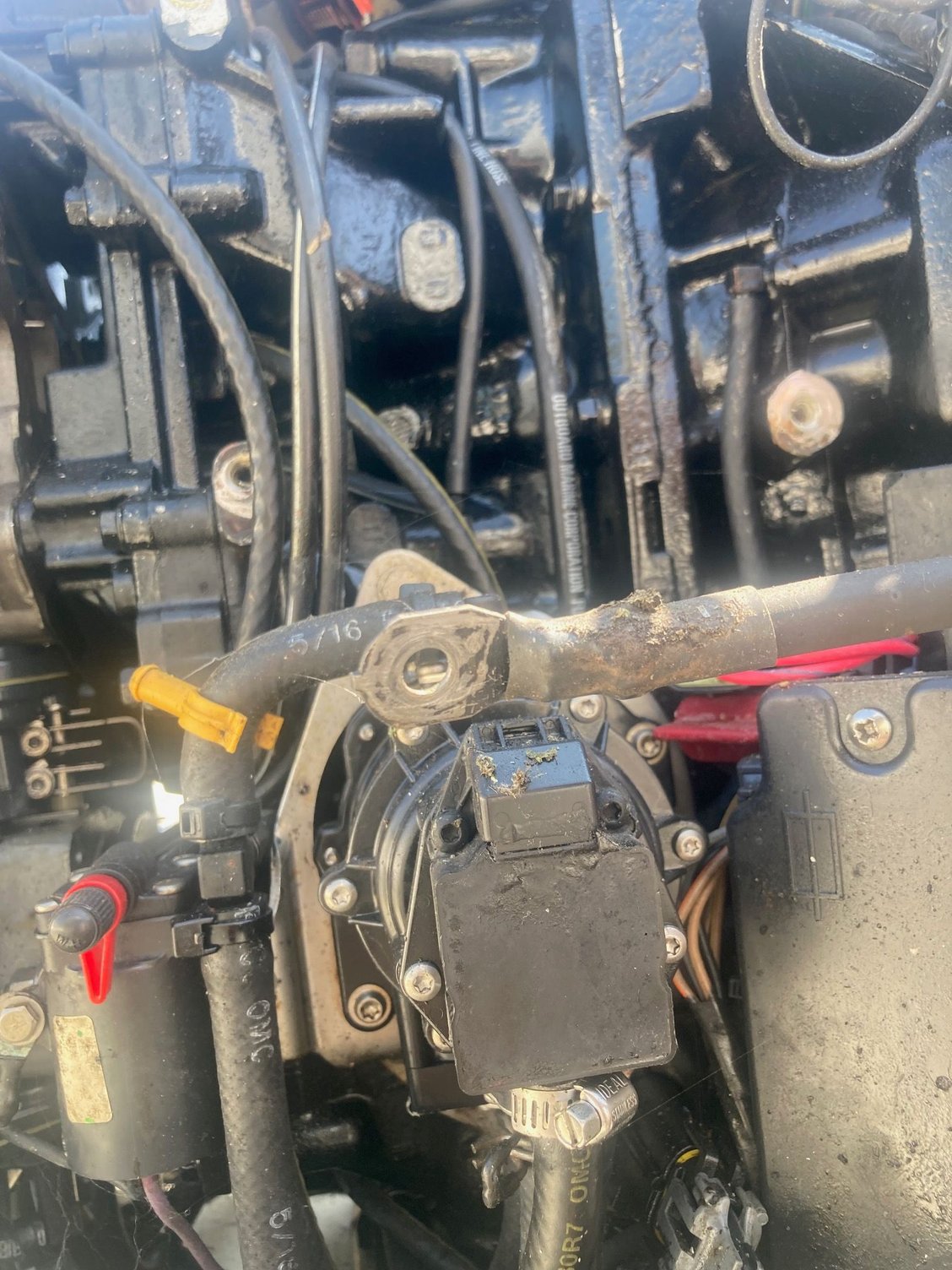

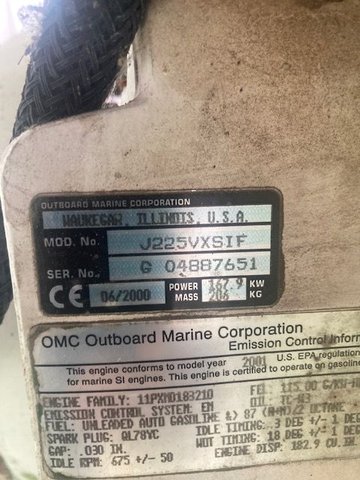

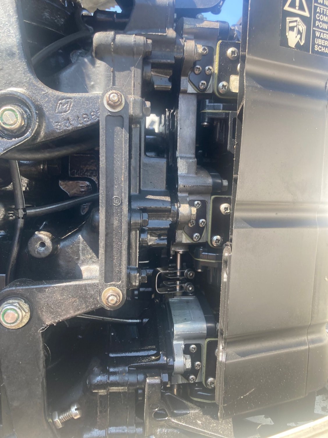

Took Cowl off and snapped a few pictures of the starboard engine,head is off it. The C.D.I unit on it lists it as a 2001 Johnson 225 Carburated Looper engine. Is this correct?
Twin O/B Sonic 08-09-2025 12:09 PM
Wow
I stand corrected.
evinrude started direct injected as Fichts in ‘98 while Johnsons continued as carbureted through I think 2001 which was their last year for production.
The cowling style on your motor threw me.
I’ve never seen those on carb’d motors before with the louvers in the back.
Most of them anyhow have that style cowling.
I would say you’re in a way better position with carbonated anyhow.
Now you’ve got something. Easy to work on and cheap to get parts for.
i’ve got a good crank if you need one, plenty of rods and rod bearings, maybe even pistons.
You can throw the block in a propane grill and heat it up and pull a sleeve out and put another one back in and save the block if there’s no holes.

Twin O/B Sonic 08-09-2025 12:15 PM
Mine are ‘2000 225 Johnson’s.
Twin O/B Sonic 08-09-2025 12:28 PM
PS, post up pixsoif the bad hole.
Now that we know there carb’d, I’ll go back to what I told you on the phone.
on those it’s normally #2 which is port side, top hole.
Check the block for broken head bolts too.
If their salty motors, the inner head bolts like to seize.
Twin O/B Sonic 08-10-2025 05:38 AM
Wrong again!
I can see by the pixs that the starboard head is off.
Based on that, I’d guess a piston lost a ring locating pin.
That powerpack is aftermarket.
From the pixs it appears very clean and to have not been apart.
Great donor motor.

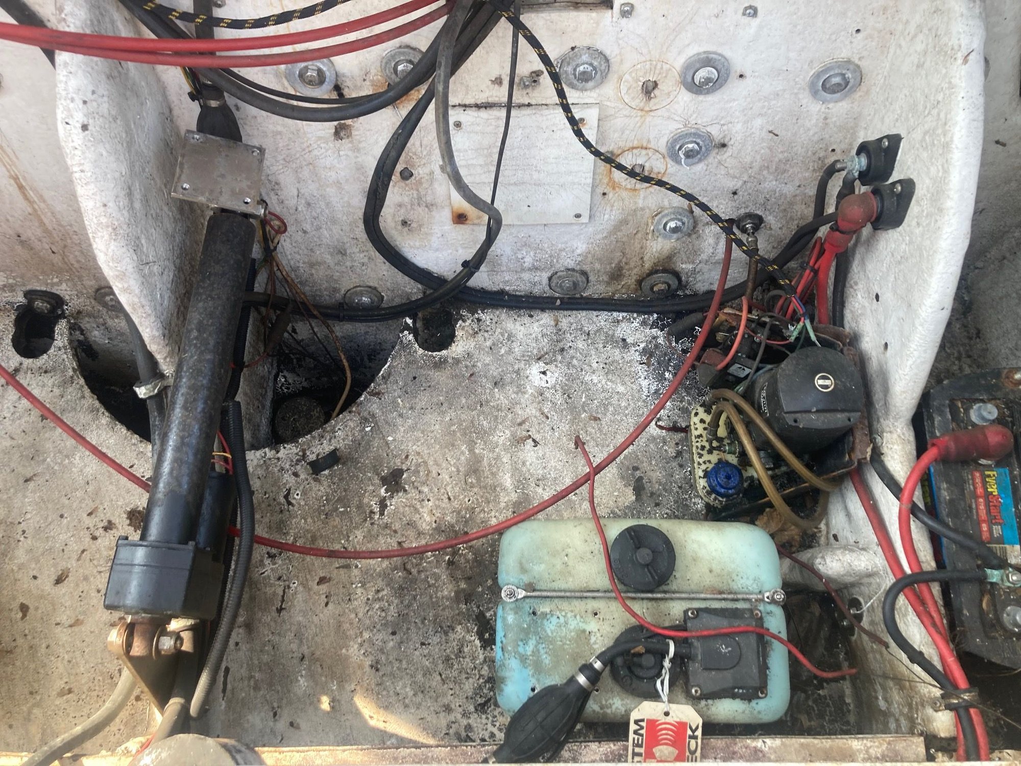

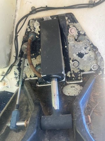

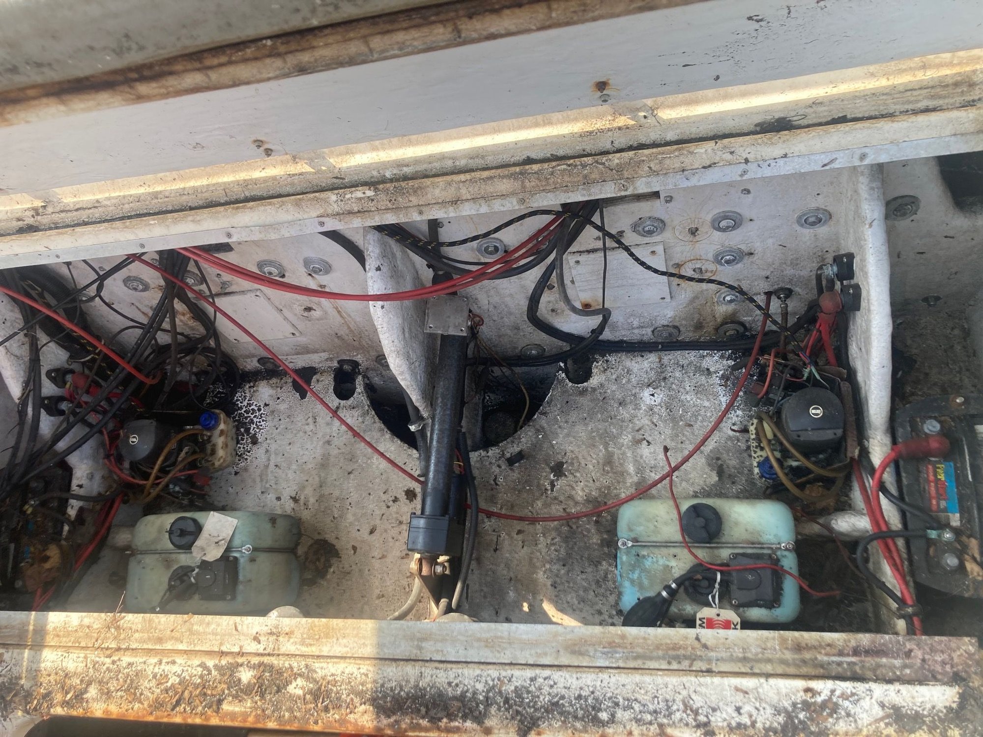

Finally got the hatch piston disconnected and the hatch open, took a couple of pictures of the engine bay from the inside, Not sure what kind of power the boat had because the holes and base are not what I'm use to seeing

I added a picture of the Armstrong bracket's part number
Twin O/B Sonic 08-18-2025 05:31 AM
The old, filled bolt holes look to be from orig Gil brackets.
My first 24’ still had them and that bolt pattern looks about right.
Not sure what the small square plates are covering but definitely not an original IO opening.
Id also say the #s on your Armstrong brackets are probably a serial # indicating mfg date of ‘2015.
From what I can see, I’d guess it was born an OB hull.
Look at the stringers a couple feet fwd of transom and see if you see any plugged holes from motor mounts.

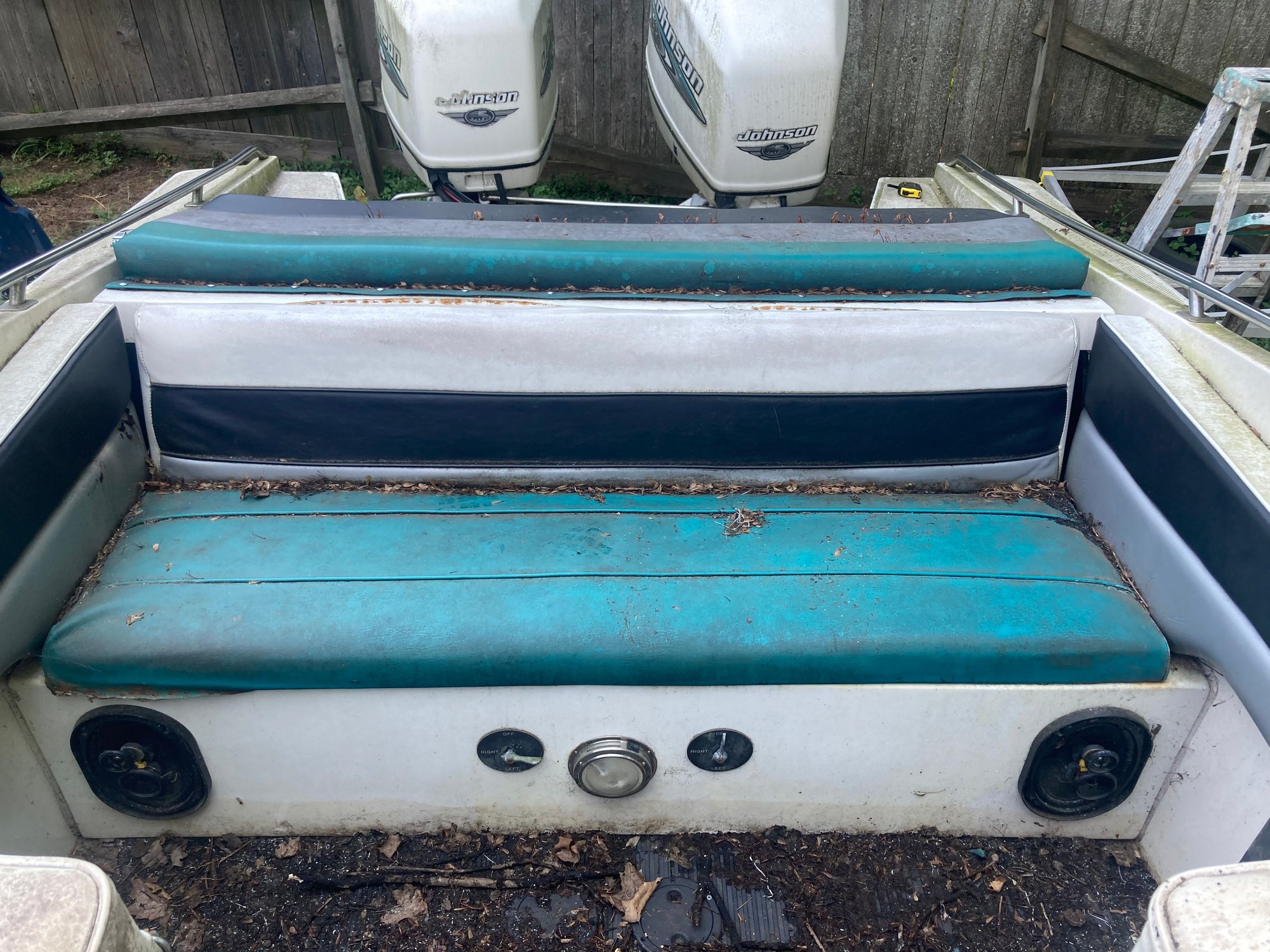

88Spyder 03-30-2026 07:22 PM
Well spring is finally here and started getting things done. fuel lines, hoses,etc.
Does anyone have an idea where the fresh water pump might be? It's got the 2 sinks with a seperate shower head, a 3 way valve for the shower head and sink on the starboard side. The fill is on the port side for the tank but I'm not sure where to look for the pump
1989 27 Sonic SS
88Spyder 03-30-2026 07:31 PM
started cleaning after a 5 year stint under a cover and closed up
https://cimg8.ibsrv.net/gimg/www.off...1a1e96a56.jpeg
Twin O/B Sonic 04-05-2026 12:03 PM
Excellent!
Looks great.
