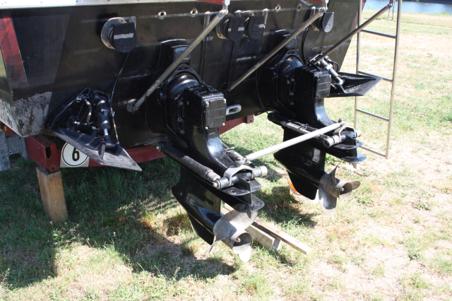

Hello
The TRS in 2023
bajalux is offline
Old 02-16-2026 | 05:30 AM
Joined: Aug 2024
Posts: 30

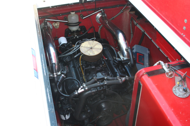

Thanks for the picture. What do you mean by 370 Mercruiser? Google suggested 6,2l which is small block. That can’t be right..
Heering80 is offline
Old 02-16-2026 | 05:51 AM
Joined: Dec 2006
Posts: 64
Likes: 11
From: Luxembourg Europe
The engine are
Mercruiser 370 (Cyclone) 7.4l Gen IV 370hp
