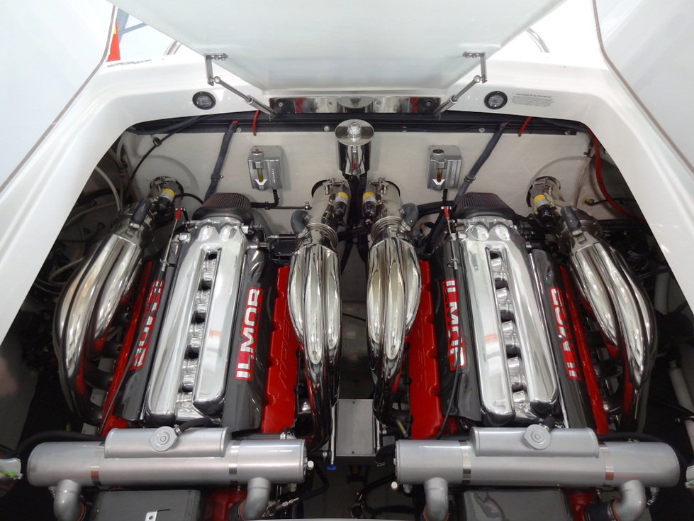

Originally Posted by teaguecustommarine
Hey NASCAT,
That Cobalt really came out cool, and it was surprisingly quick for its size. It would be an ideal boat to spend the whole day on. I remember thinking of adding a giant flatscreen under the hard bimini with some satellite TV and it would be party time!
As a performance enthusiast, I would definitely consider buying it as an alternative to your everyday bland "cruiser"
John Teague
Went to sea trial the ILMOR powered 343 you guys did the custom upfit on & it is a masterpiece. Kudos to the owner who took a chance on customizing his brand new boat by stripping the Merc power & drives & adding the ILMOR's as well as Kudos to Teague for the professional rigging job, it's nothing short of 1st class.
Boat gets on plane w/ ease, no tab, accelerates nicely & runs strong.

When the Ilmors were installed what outdrives did they use ? Or how was that all set up ? just wondering
Also anytime you add horse power to your boat you have to add ventilation and incoming air to the engine compartment. Merc has the specs on this per volume - per horsepower .
