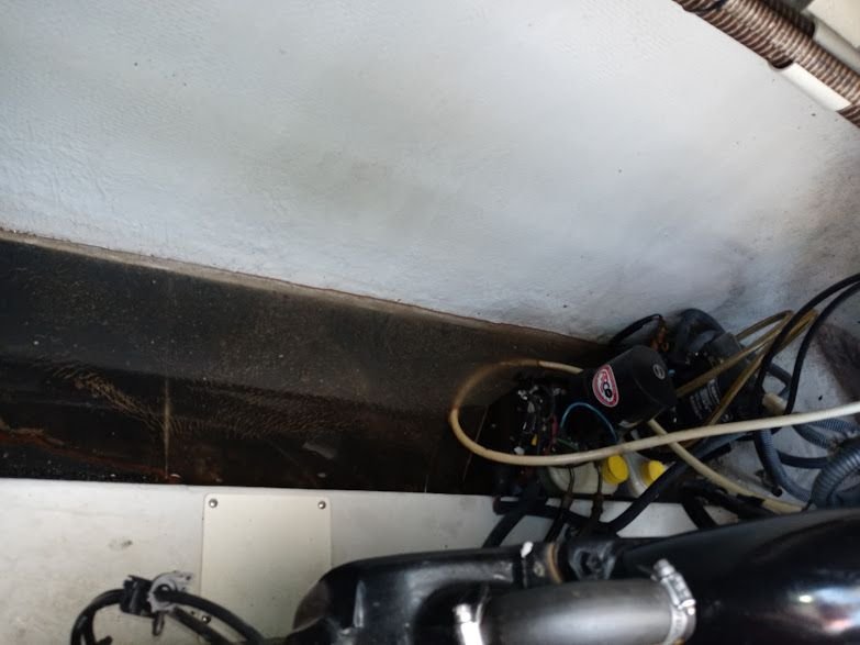

If you can easily access your bilge would you let me know if the deck the trim pumps sit on is tabbed to the transom on yours? The one on the port side is not and water just falls down between the chine and stringer. My starboard side is filling with water and driving me crazy. I'm convinced this is a layup mistake but want to be sure. I need to drill something to solve this issue.
This is what I found this morning after a few days of heavy rain here:
https://photos.app.goo.gl/Kw7XnwawVxTw1LUW8

Stitch King - Just posting your pic so later on when the link is dead, anyone searching for a similar issue can see what you were referring to
