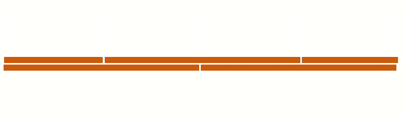

1= if you only have 2 feet of a 8 foot stringer rotted what is better? replace the bad and overlap the glass? or replace all eight feet?
2- I have stringers that are 1/2" plywood but they measure 8'6" long how do I make it one solid piece of wood? or is it ok to just butt it together?

2- I make stringers by laminating my own using plywood thats half the thickness of what i want my final thickness to be. Most of mine are 3/4"+ so i use 7/16" and stagger the butt joints. I have made twenty plus foot stringers using this method. Your is kind of an odd case though because you are just slightly over eight foot. I would cut four pieces aprox 52 inches long and then cut one in half length wise, arange them as shown. It puts the greatest distance between the joints. Bond them together using 1.5 oz fiberglass mat sandwiched between them and do all your final cutting and fitting after its constructed. Basiclly build it over dimension and then cut your stringer out of that (hope this makes sense)
