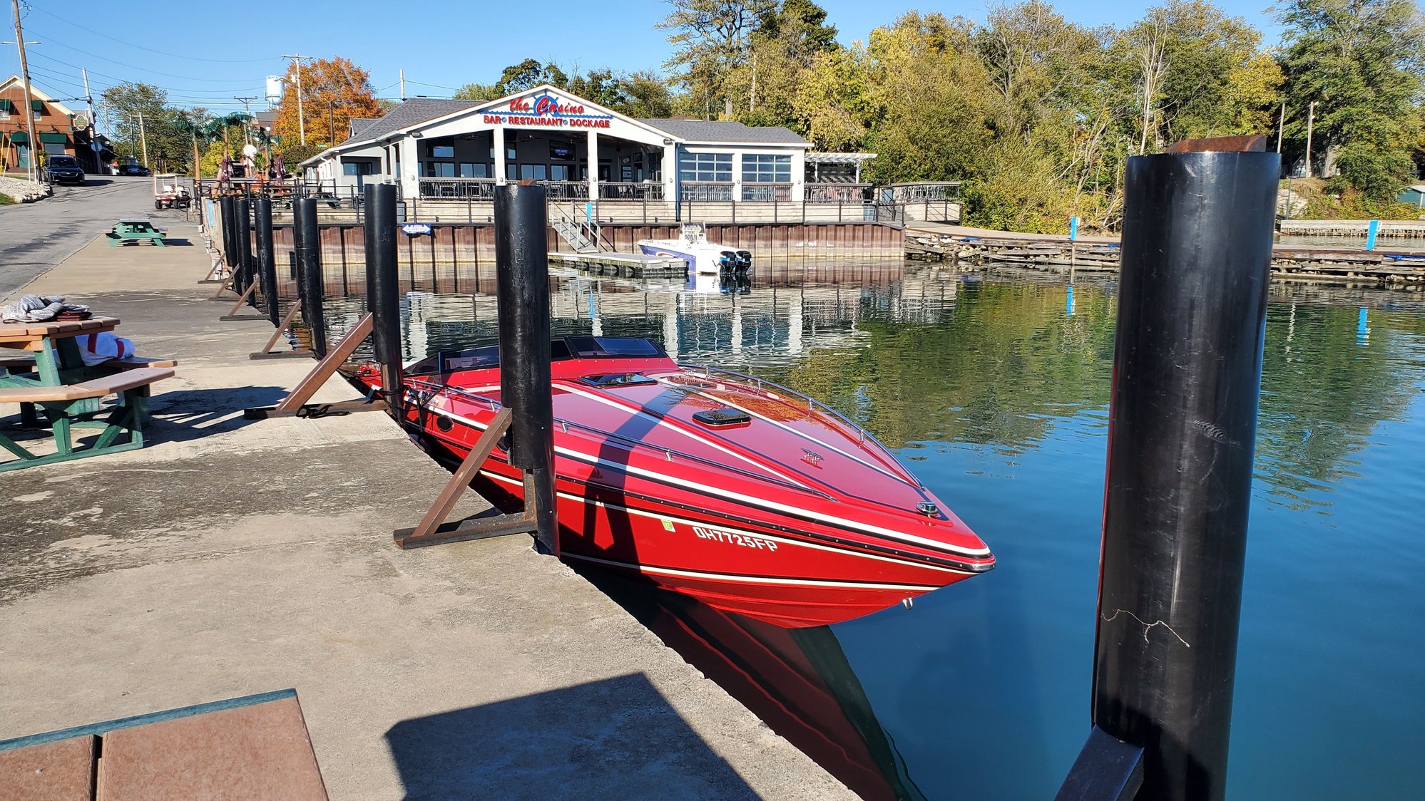

Motors running ok, still needs the timing locked out and jetted a little better but I don't think I'll get anymore out of it. 60 on the top end at 4400 with 24 bravo 1. Was hoping for 65 but will live with 60.
Maiden voiage to the Casino this week. Thankfully it was empty, still can't dock this thing. If you see a red checkmate out gab a gaff stick...
