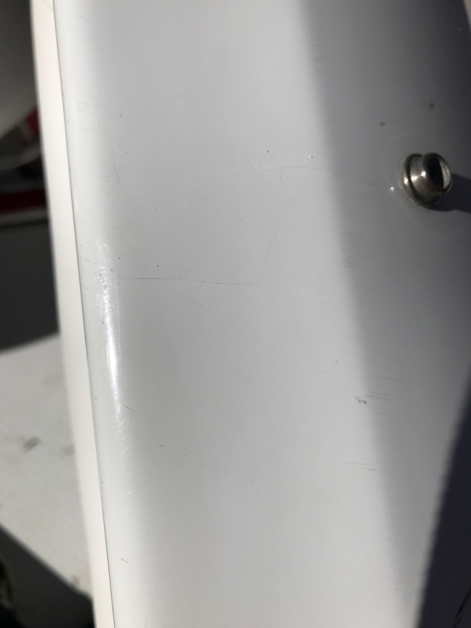

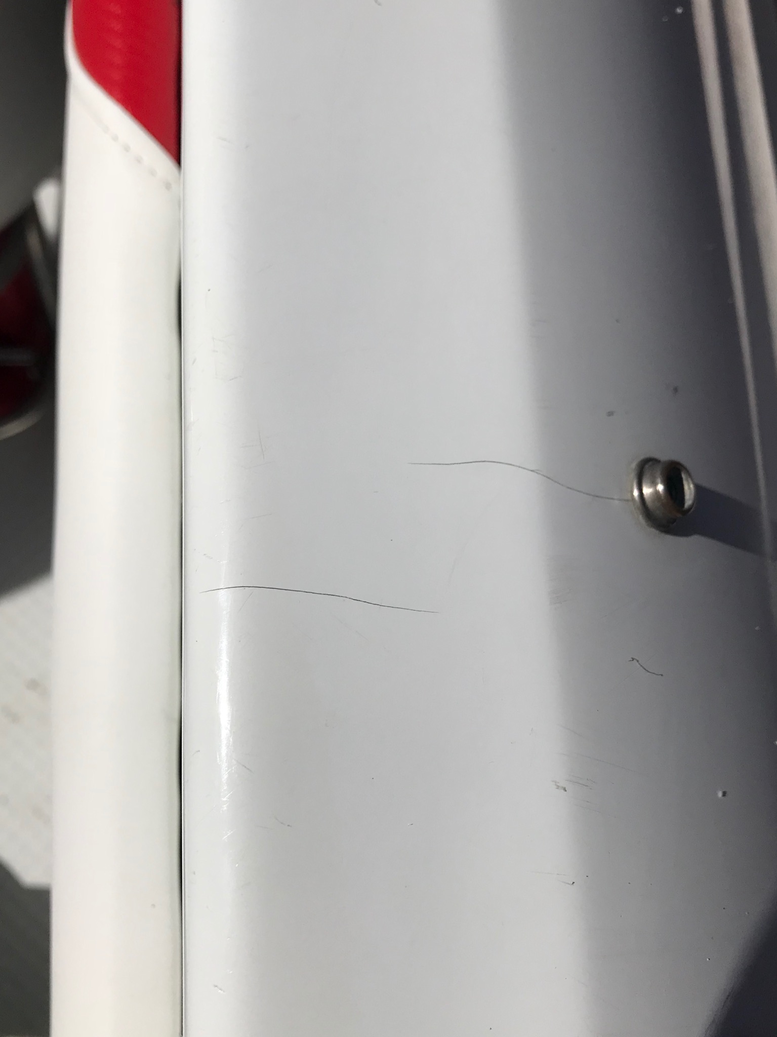

Well it wasn’t gel, but it worked pretty well. Will have to see once its cured, but filled in a couple hairline spider cracks to keep the dirt out at least. I still have to buff it out, but it needs to cure fully first.
Attached Thumbnails Magicezy-adae3f56-0cb1-4187-8480-1904fb047602.jpeg   Magicezy-b52109bc-8719-4b94-a8f5-fcf82f659f39.jpeg
