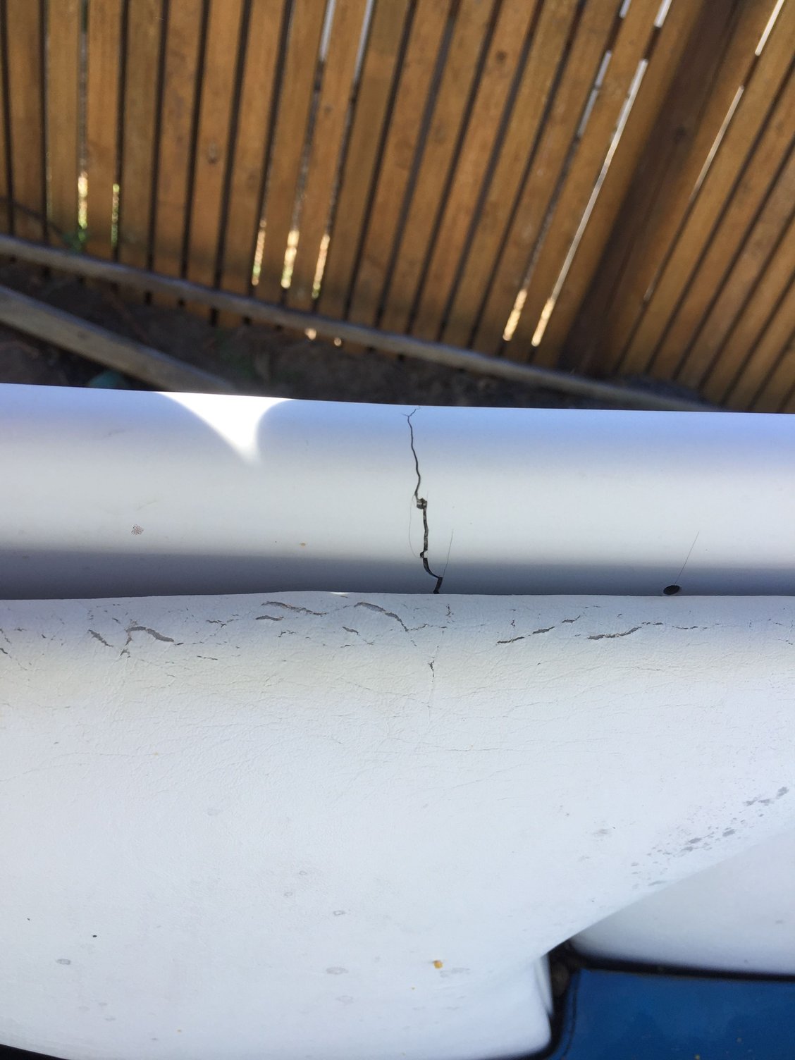

Firstly, the seller is a great guy, he’s sending me lots of photos, including pics of the things most people wouldn’t want you to see.
Transom has a decent crack in the port side corner of the splashwell, pretty common I expect. Trouble with rebuilding the transom, I think the deck would need to come off and that might make it too much effort. Replacing the floor is more straightforward.
Transom crack
https://cimg1.ibsrv.net/gimg/www.off...2c15e2637.jpeg
https://cimg2.ibsrv.net/gimg/www.off...1e6fbb723.jpeg
inside transom, it doesn’t have a full beam transom, only a center piece because the pods/swim steps are empty.
https://cimg3.ibsrv.net/gimg/www.off...1b59a22fa.jpeg
https://cimg5.ibsrv.net/gimg/www.off...b7d8f1c75.jpeg

Also has a crack on the very top of the deck next to the passenger seat. Photo looking down on the crack from above and another close up. Once again, if this is significant, it might mean ‘deck off’.
https://cimg8.ibsrv.net/gimg/www.off...43679421a.jpeg
https://cimg9.ibsrv.net/gimg/www.off...fe6de2879.jpeg

1Zoom 07-25-2021 07:17 AM
Rak, this looks similar to what you would see on a bass boat. Very common issues, I have seen a couple of guys that pull the back 1/4 of the deck, cutting it in a small area with some access to the back side through the gunnel. With the floor out and the back section of deck off, you could do a nice repair. I would probably beef up the kicker supports to the transom as well. Good luck and take lots of pictures.
