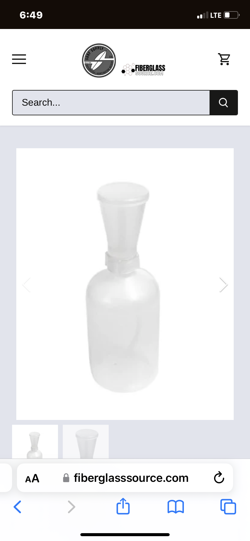

Volume
Buy a dispenser bottle for youre catalyst.
Best investment you’ll make.

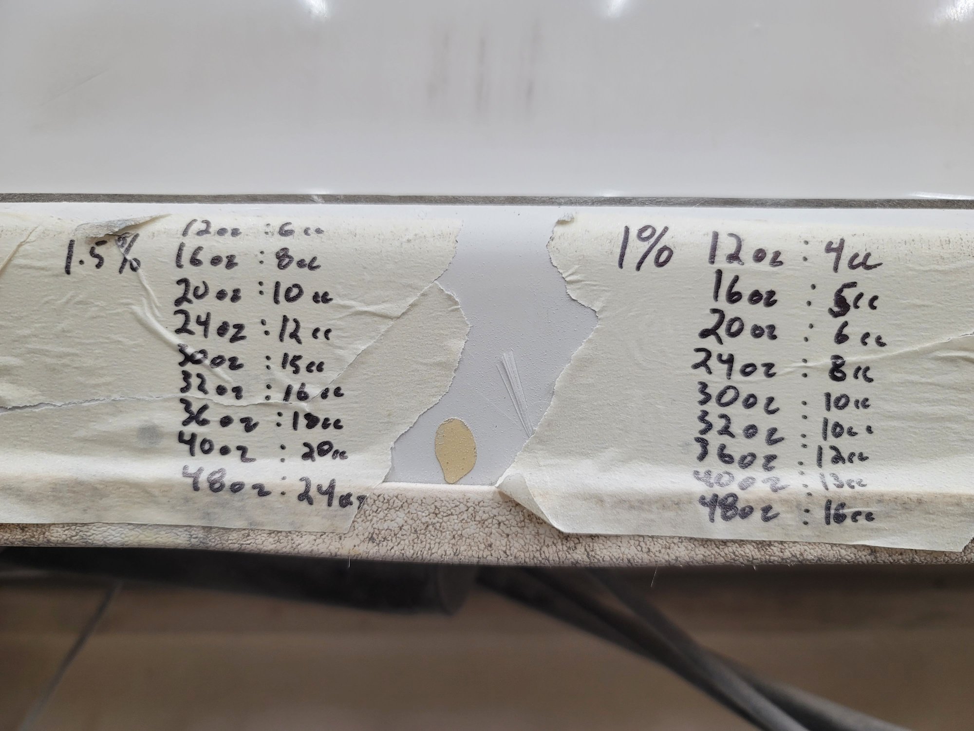

The biggest improvement to my Fiberglassing abilities, and was drastic, was finding and using this dispenser bottle and the ratio chart.
The bottle has a scale on the dispenser section of bottle.
I’ll get a picture of it later today.
I have it taped on the front of my toolbox in the shop.
Simplest one I’ve seen.
Lists cc of catalyst per ounce of resin.
Go to that chart, squeeze that amount into the dispenser section on top of the catalyst bottle and you’re done.
Only variables are ambient temperatures of area you work in which can double or reduce by 50% the amount you used to get it to go off when you want.
And that you’ll get used to it time.
