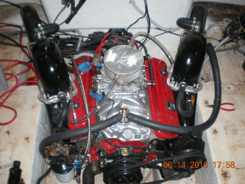

Finally have the engine in it's final mock up with the exhaust on. Took a lot longer than I thought thanks to a frozen broken stud in the aluminum exhaust manifold. It's ready for the final resting place (knock on wood). If you look between the manifold and the riser there's a 1/2" chunk of aluminum I made with two sets of holes so I could rotate the exhaust about twenty degrees and make it exit where I wanted. The pipes are dry all the way to the down turn.

Haven't had much time to work on the boat. Work has been crazy busy. The engine is in it's final resting place and you can see what the exhaust ended up looking like. I'm pretty happy with what I was able to come up with.

The down turn exhaust looks great. I had something very similar fabricated for my Mariah Z302 using 4" PVC to form the correct angles and departure out of the transom. My boat is very quiet at idle and exhaust is fully open when up on plane but pointed downward so somewhat muffled.

I've never been a fan of side exhaust. I thought about it but I wanted the exhaust to be above the water line and didn't think side exhaust would be too dock friendly.

The package I put together should be making right at 400. Got it to the point of cranking over today but have some timing gremlins and ran out of time. Hopefully tomorrow I'll get it to fire off.
